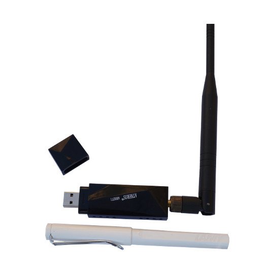

Just go with a free software approved usb device
https://www.fsf.org/news/tehnoetic-wireless-usb-adapter-now-fsf-certified-to-respect-your-freedom
This one should obviously be supported, but if a handful of others was (maybe with a smaller form factor), that would be great !
