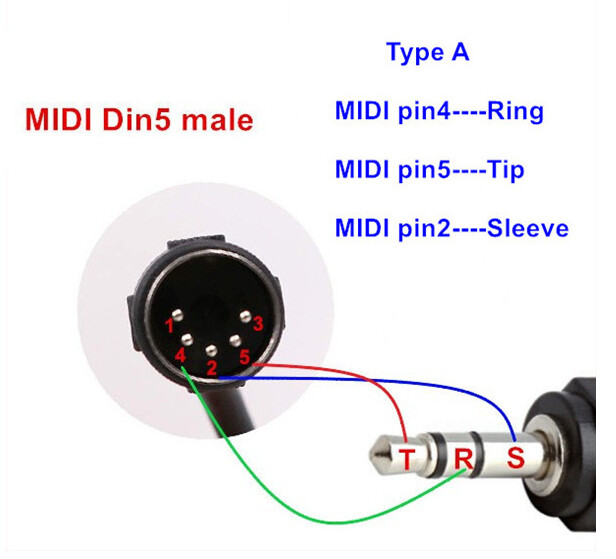

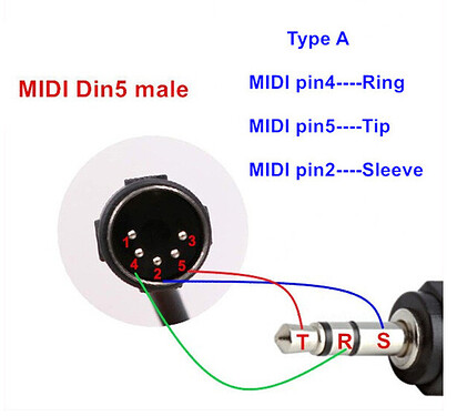

Dwarf MIDI cables, here’s how:
First, most poeple already have hanging around a male to male 1/8" (3.5mm) Stereo cable. If not, get one the length you need:

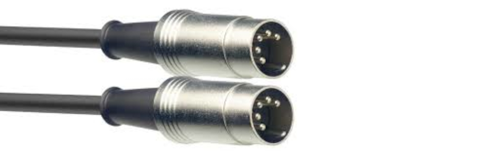

The same goes for a regular MIDI 5 pins Din cable. If you have a need to use MIDI with your Dwarf, chances are you already own such a cable. If not, get one.
Then, the fun starts:
  • Cut both wire exactly in the middle.
  • Skin the end of each cable to expose the copper wires.
  • With the help of a multimeter, find and take note of what wire color goes to which pin on each connector.
  • Take a DIN half and solder its wires to those of a 1/8" (3.5mm) TRS half according to this pinout:
Repeat for the remaining halves.
No soldering skills? No problem, simply twist the wires together and wrap in black electrical tape Individually of course to not short circuit them :wink: But soldering the wires will garanty a better conection. Maybe it’s time to lear a new skill and be proud of your selves.
No multimeter or continuity tester? No problem, watch this video: Home made continuity tester
Once both halves pairs are done, you have all the cables required to do MIDI in and out on the Dwarf.
