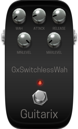

This could be for you:
Or this :
Oh!Thanks!!
I guess they have thought of everything!! ![]()
Cheers

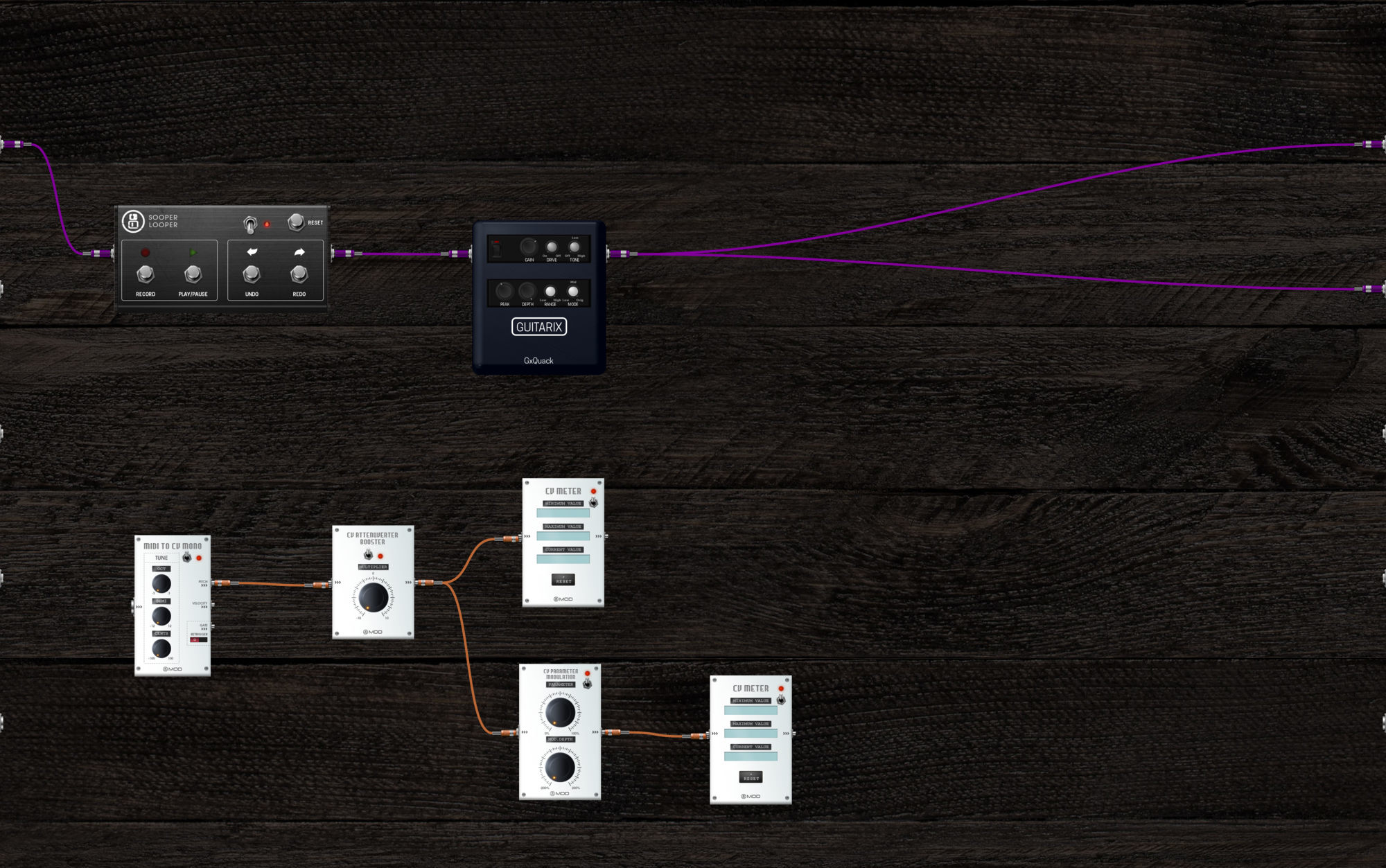

I guess it is too far from your request, but here is my take on controlling wah pedal anyway.
I am using KMI Softstep2 for auto enabling the wah with a rubber button pressure.
KMI can generate a cc signal when you just put you foot on the rubber button. I use it for controlling switchbox and selecting wah or wah-less sound.
Button pressure controls wah depth via a separate CC signal.
If I had to use a regular expression pedal, probably I would try to do some thresholding with CV plugins, to flip that switchbox once pedal reports non-zero value
Wow!
Thanks!It looks complicated!
The switchless wah might be easier ![]()
