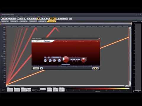

I tried the AmpVST with a distortion in front since it is not a so high gain amp and oversampling 8x helps, aliasing still there but less noticeable than Titan and Onyx. Maybe we can just stick an oversampling and downsampling plugin in front of plugins that generate lot of harmonics? These operations obviously increases CPU usage. This is a key factor to consider in buying a digital amp modeler.

Great explanation! So it seems that 8x oversampling is the best tradeoff for live playing. 16x I suppose would introduce too much latency.
Yes, oversampling kills performance.
