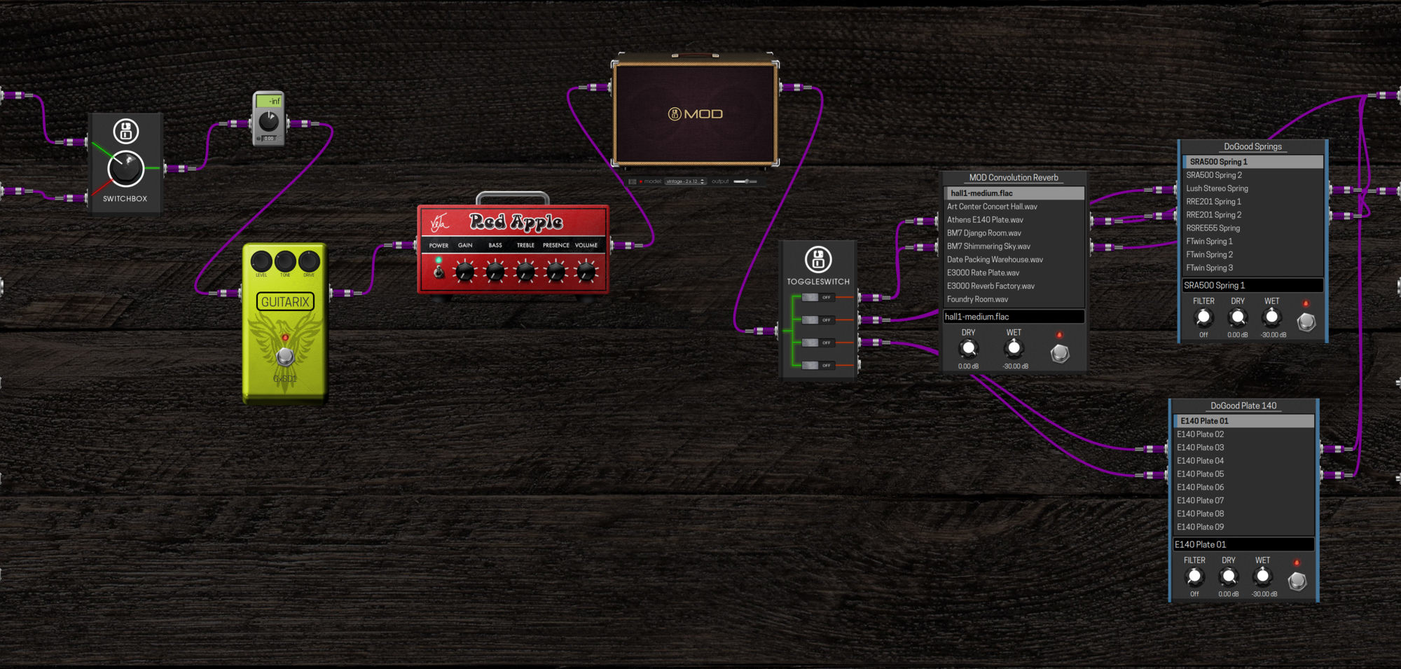

I’ve tried to make an update but the problem remains. I recorded a sample:
Can you really run this pedalboard?
My Dwarf runs with 100% CPU load.
So it is overloaded and I assume that this is also the case with your device.
I use DuoX so there is still more than 50% of free cpu.
Ok. That’s the advantage of the DuoX. With the dwarf you really have to be carfefull with the CPU load when using some plugings like the DooGooSound Reverbs or the Red Apple. Adding just some more effects can quickly bring the CPU load to the limit.
That’s why I love my DuoX, it lets to get crazy with plugins ![]()
I maight have a problem wth loading a licence of Red Apple, thats why there is no change with redapple.
those convolvers are really cpu intensive, having 3 of them is dangerous and can lock up the dwarf while all the background processing compete for resources.
try to use a single instance of such reverbs
Thanks for warning, i’m aware of it. The board was the example board for the distortion issue with the red apple plugin.
The CPU load on the dwarf might become a problem in the future with online pedalboards. If DuoX users relase pedalboards and a dwarf user loads these pedalboards it can happen that the Dwarf is locked.
Adding a flag that shows the hardware where the board was designed on would be a first security step to avoid such problems.
Next time I will make more CPU friendly pedalboard, so Dwarfers will also be able to check it out.
