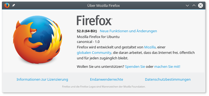

I just tried to install 343 again with FF on Linux (Kubuntu):
No - won’t work. Only with Chrome it works…

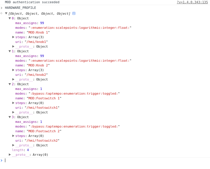

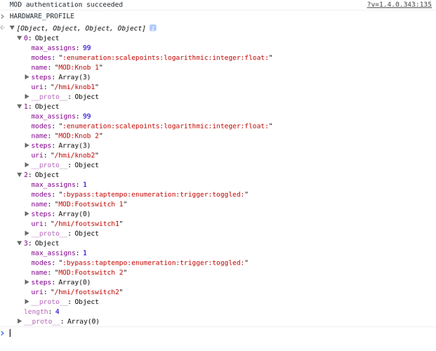

I tried this (with Chrome) but got nothing interesting. Here is what I have done:
  1. Update Duo with Chrome to 343
  2. Downloaded and installed last ControlChain library (2 days old) for Arduino-IDE-1.8.1
  3. Used the example sketch (Button) - only added digitalWrite(ledPin, HIGH); to avoid the pull-up resistor
  4. Uploaded the sketch on my Leonardo
  5. Tested the sketch (connecting GND to pin7 => LED13 is on for about 10 secs)
  6. Connected the Leonardo to the Duo USB A connector (with the same cable used for programming)
  7. Using Chrome for http://192.168.51.1
I cannot see anything useful. When going to console and entering HARDWARE_PROFILE I get:
What do I have to expect in MOD-UI or the console?
Regards, Holger

@falkTX i’m also having the “checking file | invalid file” loop on firefox in Ubuntu. i’ll go try google chrome…
…and, yes, it’s fine in chrome.
weird!
I’m too lazy to look into the javascript code doing the update, but I suspect automatic decompression of the downloaded file performed by firefox making the subsequent file hash check fail. @falkTX
