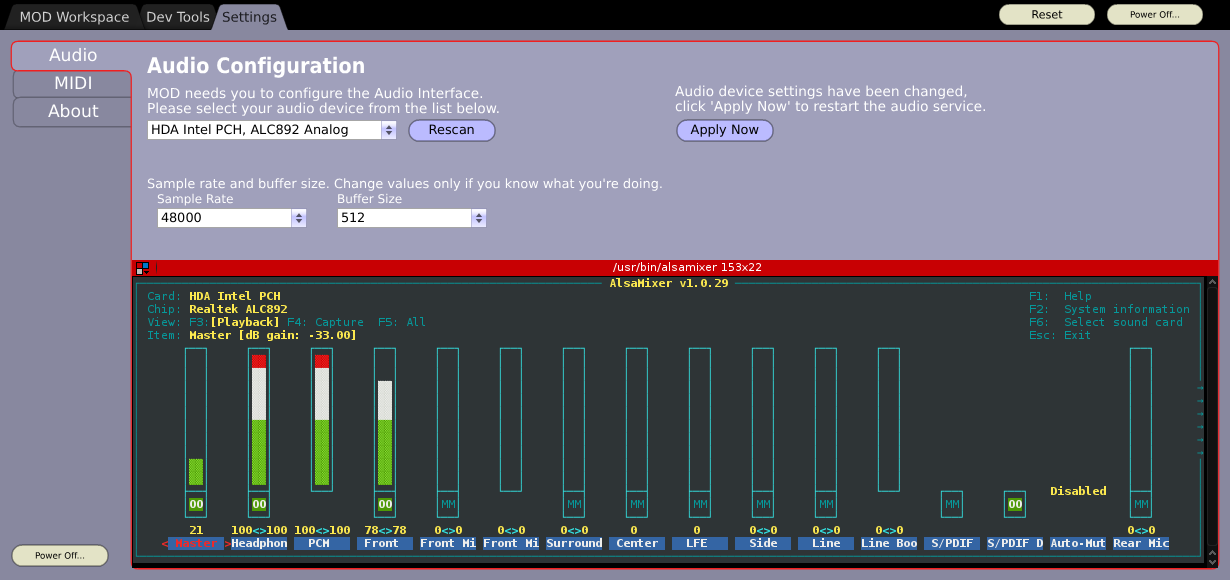

I think you missed the audio configuration settings:
Just lower the buffer size and click “apply now”.
There’s a terminal available under “Dev Tools”.
I forgot what the username was, but you can open that terminal and run “whoami” to find out.
The live user has no password, and can use sudo.

The Dev Tools is the 2nd tab on the top-left. See the screenshot I posted.
I don’t know how you missed it…
