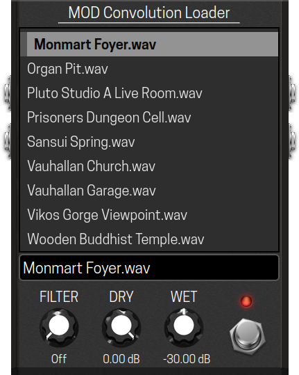

From the huge amount of plugins - which one would fit for such an instrument IR?
This one (which I use for acoustic piezzo guitar) :
The description says: This plugin is specifically created for handling speaker cabinet IRs, this plugin is not optimized for handling larger files like reverb IRs.
On a 3Sigma video about the usage of their IRs they say that acoustic IR files are very large/long.

Their max length is 7200 Samples. The MOD Audio IR loader cabsim only loads 2048 samples.

I would reccomend 3Sigma Audio upright bass IR. I bought the Prescott bass package (15$) to use with my electric fretless bass (Rotosound Tru Bass 88 strings - black tapewound) and the sound is quite close to an acoustic. The package includes directories with various types of different IR’s for el.bass, piezos and other models of basses. Each has IR’s sampled with various rates up to 96kHz. I loaded the 48kHz, the MOD internal SR, with an IR reverb loader.
You woldn’t want to use a cabinet loader. As I understand cabinet loaders are meant for short responses (~40ms ?) and you want to have a longer tail for acoustic simulation, so use the two options made for reverbs.

I bought an IR package from 3Sigma and tried the free upright IR from acousticir.free.fr. and loaded them with the MOD convolution loader. Several hours of tweaking with all the files and parameters did NOT end up in a reasonable upright sound. Our expectations about “sounding close to an acoustic” may be different. But the sounds from the 3Sigma upright videos can only be reached if you already play on an upright.
The best result I got and what I use now is just an EQ and a little room reverb. That IR things did not produce any additional upright bass sound (with my acoustic fretless piezo bass). Unfortunately.
