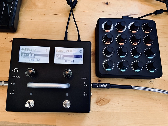

My setup:

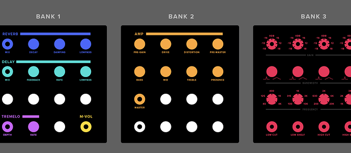

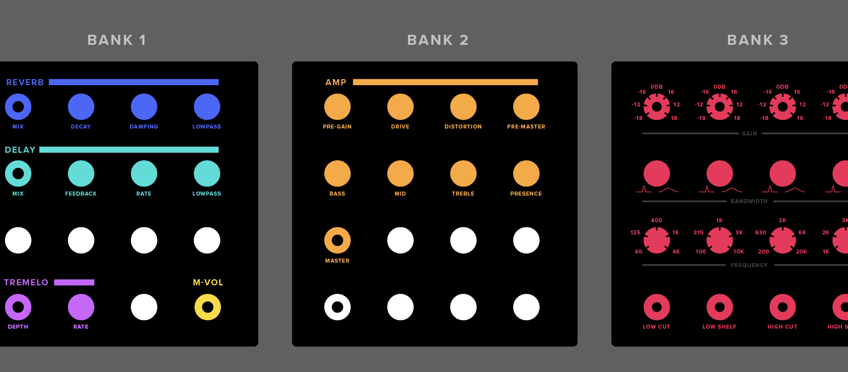

And my midi fighter twister mappings:
