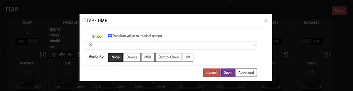

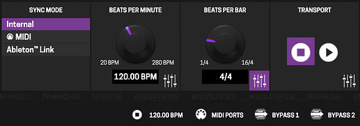

As you are synced to the master tempo, you need to do this assignment in the master tempo
That is not the same as changing the subdivision of the delay. I should be able to have 1/8 note delay while leaving the beats per bar untouched - otherwise any other time-synced plugins also change their behavior.
The part that needs to be assignable for this is in your previous screenshot, the dropdown list that is currently set to ‘2T’
Select “sync to host tempo” in the adressing dialog and choose a button or knob before pressing save, that way you will get the list of subdivisions adressed to your device.
I agree that this is not an ideal user experience, and it is on our list of things to improve. The target being having a “sync” button next to the relevant parameters in the plugin settings screen, which would then turn the knob into a list of subdivisions. This list could then be mapped to a control with the usual workflow.
