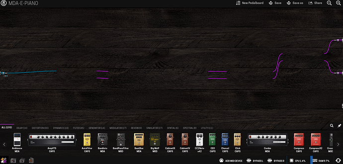

Great - pedalboard changes are working! Very nice - many thanks!!!
… one thing: After “reset” the UI shows cables and the “old” name:
After reloading the web page all “cables” are away. I will check if this also happens on the MOD-Duo. BTW: How can I connect to the MOD-Duo with ssh?
