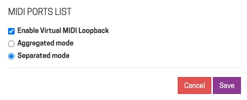

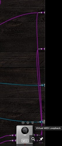

a) I never see anything under the separated mode (screenshot attached), even if I run MIDI into the Dwarf. Shouldn’t I see the different MIDI ports mentioned as a list?
b) Yes, I do use the Virtual Port, screenshot attached, too.

Everything that I can see is correct.
The problem is that you are not showing the MIDI input section. Are you use the virtual loopback port there as MIDI input?
