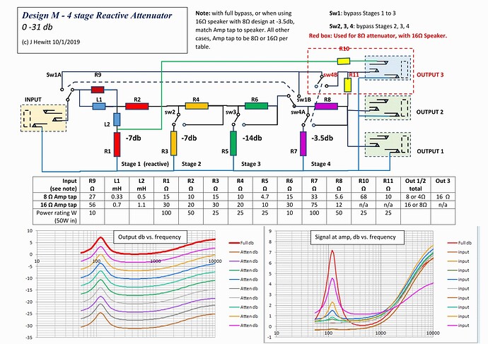

    I find this one a bit trickier…
    Both of my amps have at least two speaker outputs (4 ohms).
    This way I could have a cabinet connected to one of the outputs while recording the audio from the other output and not damage the amp ( I don’t have a reactive load ). Is this possible?
    If it is, I imagine that I will need to attenuate the speaker output signal to a line level to be able to send to my interface(DAW) and record it. Correct?

I’ve explained this badly. With speaker out I mean an adapter (attenuator) to be able to provide a suitable input level to the recording interface. If you already did this succesfully with the 2nd output of your amp then it’s fine. Another way is to use a rective load, so that you don’t need to play the amp loud to achieve the desired tone. Also a reactive load should not damage your amp.

I don’t have the equipment to record the audio properly to make the training models of my amps at the moment. I would need to buy at least resistive load with a line level output (attenuator).
The price for a reactive load here in Brazil is just crazy expensive (+or- 450EUR)

But… Considering the cost of the that “Torpedo” reactive load around here, this project could make a lot of sense.
