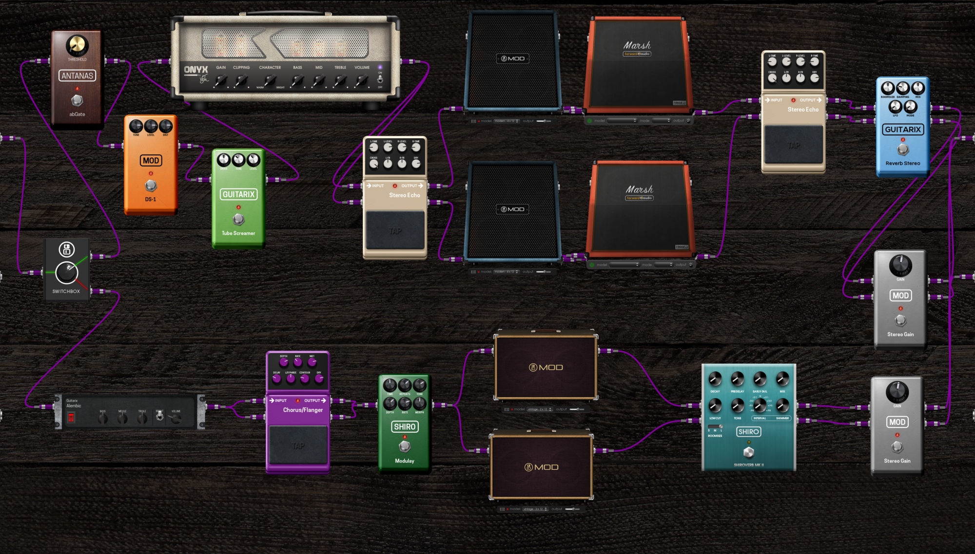

I made a new pedalboard in the spirit of the lead guitar sound that Steve Stevens plays in the Top Gun theme.
After the solo part, I made an adaptation of the theme with a classic finger fingering and created a clean ambient patch for it.
We can very well use these three sounds in another context.
Too bad that the changes of snapshots generate a gross cut of the effects.
It is a cool board! The sounds are amazing! I will try this board this sevening after returning from office.
Dann, you wrote: “Too bad that the changes of snapshots generate a gross cut of the effects”. You can avoid this in my opinion by using Control Voltage PlugIns. I created something to turn the knob for endless decay. Take a look here: (Kitschy ambient)[Kitschy ambient - MOD Devices].
If you want to fade out the effects, like reverb ro something comparable, you should add a control voltage plugin that turns down e.g. the decay within half a second or a second. Then there will be no intersection of effects any more and also the transition will be smooth.
