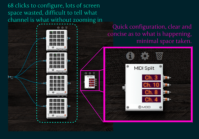

One plugin feature request that is immediately apparent (and may already exist, not sure):
A MIDI channel splitter - One midi input, [n] outputs (I’d use 4 with my LpP) - One (selectable) channel per output.
I needed to use 4 MIDI channel filter plugins to get the different sequencers and pages to only control the individual plugin I want. There may already be a better way to achieve this, but I am envisioning this being relatively simple to implement in one ‘channel splitter’ plugin.

Sorry for the delay in responding to this, I’ve been pretty busy. But here’s an illustration.
It takes 68 clicks for me to configure this - adding and connecting 4 separate filters, and manually turning off the 15 unwanted channels on each. And if I want to set it up on a different pedalboard, I have to do the entire thing over again. And also it’s impossible change assignments on-device without the webUI.
There may already exist a better way to achieve this - if one exists please let me know - and my request may be too niche to take seriously - but IMO anyone who wants to simultaneously control multiple synths/drums via external MIDI would benefit from it.
My example is 4 outputs, but it could be as many or few as desired. In a real implementation I would make the text larger as well.
I’m imagining channel selection to happen similarly to the x42 sequencers - just scroll the wheel to make a selection (or assign to a knob on-device.)
I used an existing CV plugin for the base to use as a scale for a plugin that has 1 input and 4 outputs - so this is a realistic size comparison.
Edit: An alternative to this would be to allow assignable channels in the plugin configuration screen.
i use the note range filter for this. You still have to put it on the pedalboard four times but it has a smaller footprint.

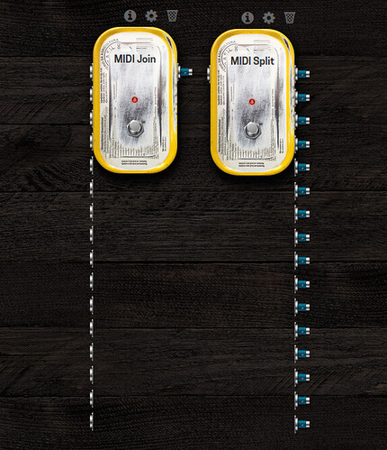

I already have such a plugin btw. 1 midi input, 16 midi outputs. basically 1 output per channel.
That looks like an improvement, thank you.
Is that available on MOD devices yet (beta or otherwise) or do you mean you have one included in kxs that could be ported?
Edit: I also just found the "MIDI 1 Channel Filter’ from x42 which is another improvement. Not sure how I missed that one honestly.
It is in beta already.
Though it looks quite crappy, needs a modgui and some tweaking to reduce padding between jacks, so it takes less space.
There are both MIDI Split and Join plugins. Split makes each input channel output in a different MIDI port.
The Join one will make all MIDI from a port automatically have their channel converted to the matching port.
