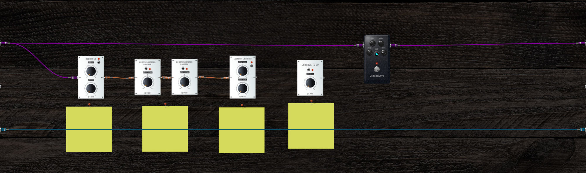

This pedalboard
It works wonders. I’m unclear however on how the ABS works, and why a few parameter mods are required. Can anyone give a nice explanation as to how this pedalboard works?
I wish there was a single plug-in which worked as an effective envelope follower, but this works. I’m just curious as to how exactly it works, so that I can possibly integrate it into my pedalboards.

In the order of the Audio → CV signal
  • The 1st TinyGain just amplifies the audio signal
  • the Audio to CV does the real job, it transforms the amplitude of the audio into a CV value
  • the CV ABS keeps the value positive
  • Slew rate limiter slows the changing values of the CV, you can slow the rising and the fall differently
  • the 3 CV parameter modulation is there to amplify the CV signal
I didn’t have time to try with less plugins, but I think the 3 CV parameter modulation (maybe the CV ABS too) could be replaced by a single Control to CV - MOD Audio with the advanced parameters put in the right spot… I’ll take time to do this later
Here is another version with only 1 CV plugin less, and 1 audio plugin less…
And I’ve put some notes to explain each step.

I love this example. It didn’t use the CV ABS, and didn’t need to. I now know the various multipliers used in the original pedalboard at the top of this thread was to keep boosting the signal - that wasn’t clear to me. I’ve always found the Slew Rate Limiter did exactly as I expected, but the cool thing I didn’t think of was adding the Control to CV at the end of the line to limit the range - that’s a great idea ! CV to control a control to CV plug-in! This is really helpful Rom.
