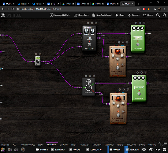

As a workaround, until we improve the functionality of the devices, you can use the following technique using the x42 stereo X-fade plugin:
By doing this, you can use the bypass button of the stereo x-fade plugin to achieve the same result as toggling between channel 1-2 on the switchbox.

Great tip! Thank you! I’ll surely use this workaround.
