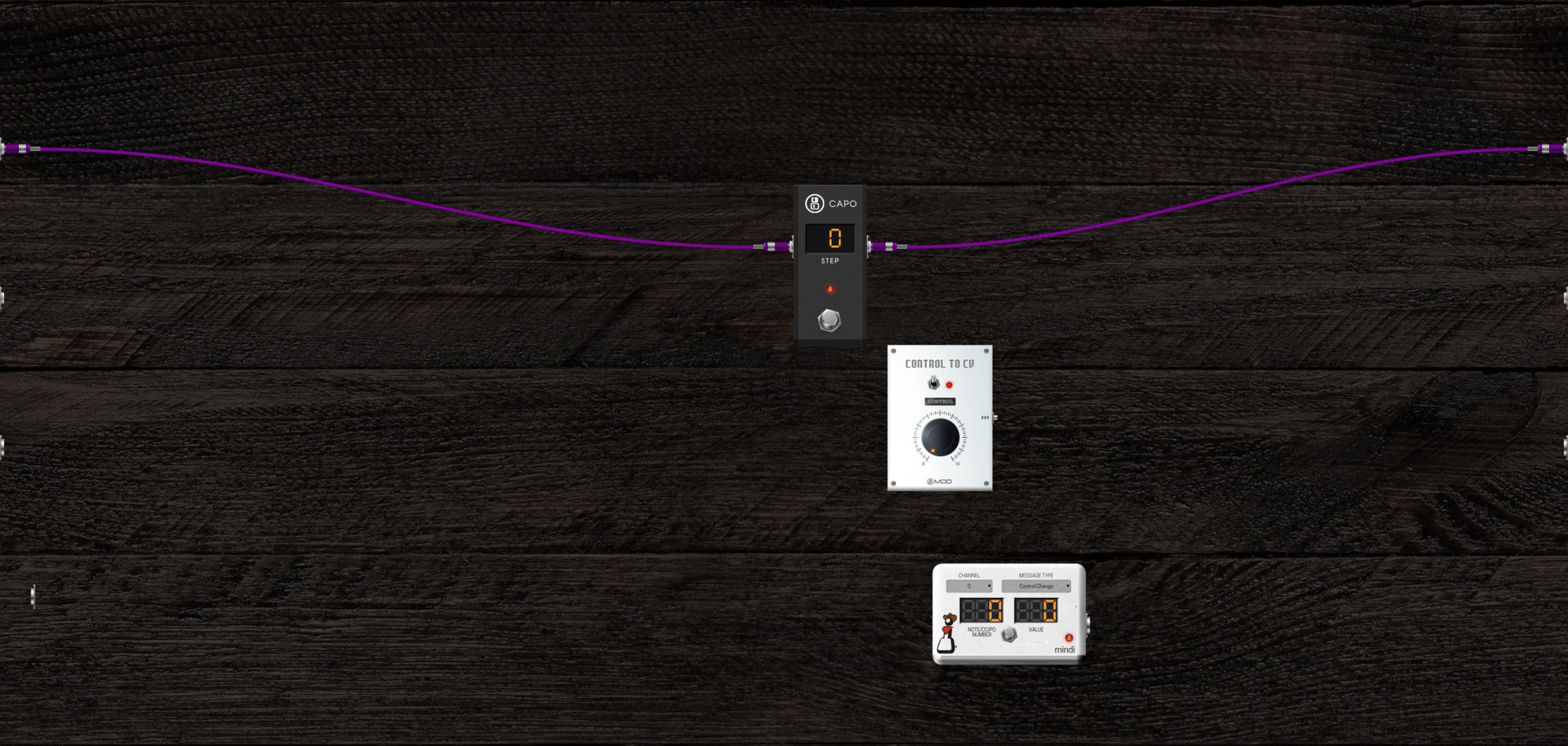

If you only need the option of using Dwarf’s footswitch as a fallback, you could use Control Button Board plugin: it’s not in the store, but you can find it in this thread:
Basically you can control the Capo plugin with CV, and in Control Button Board plugin you will activate the CV with any of two switches:
  • one to be mapped on a Dwarf’s footswitch
  • one to be controlled by midi
    If at least one of the toggles is ON, the CV output will be set to HIGH.
    The state of Capo plugin will be shown by the led of the Dwarf footswitch.
It’s great to setup a pedalboard to be controlled via MIDI while having the fallback option to control it just with the Dwarf in case of anything bad happens to the MIDI controller.
Many thanks for the hint! I’ll test it
Another option is to use the Mindi plugin to send the same signal as your external midi controller. You assign on/off with midi learn in the Capo plugin using your external midi controller, set the Mindi to send the same signal (I think you need midi loop back enabled), and assign Mindi Value to the CV of the Control CV plugin, and finally the CV plugin on/off to the physical switch.
I’ve meanwhile tested the new setup at a few rehearsals and one show. So far it’s been working perfectly :+1:
