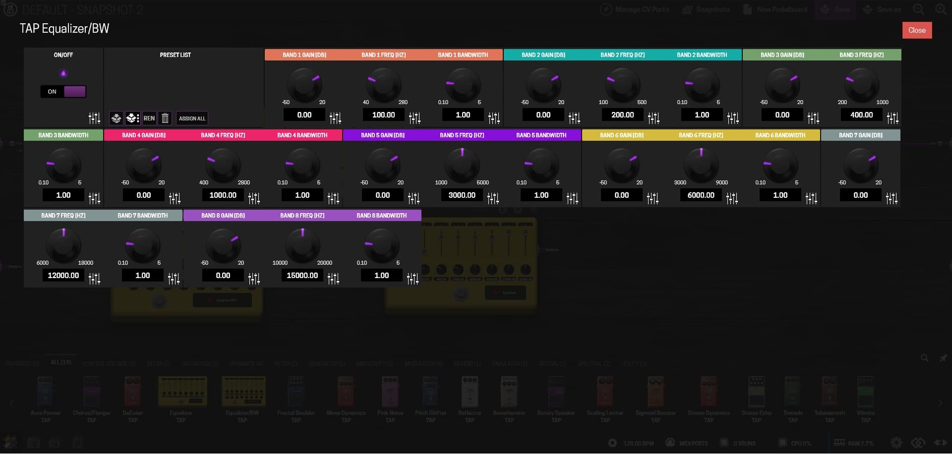

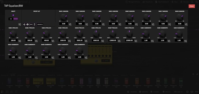

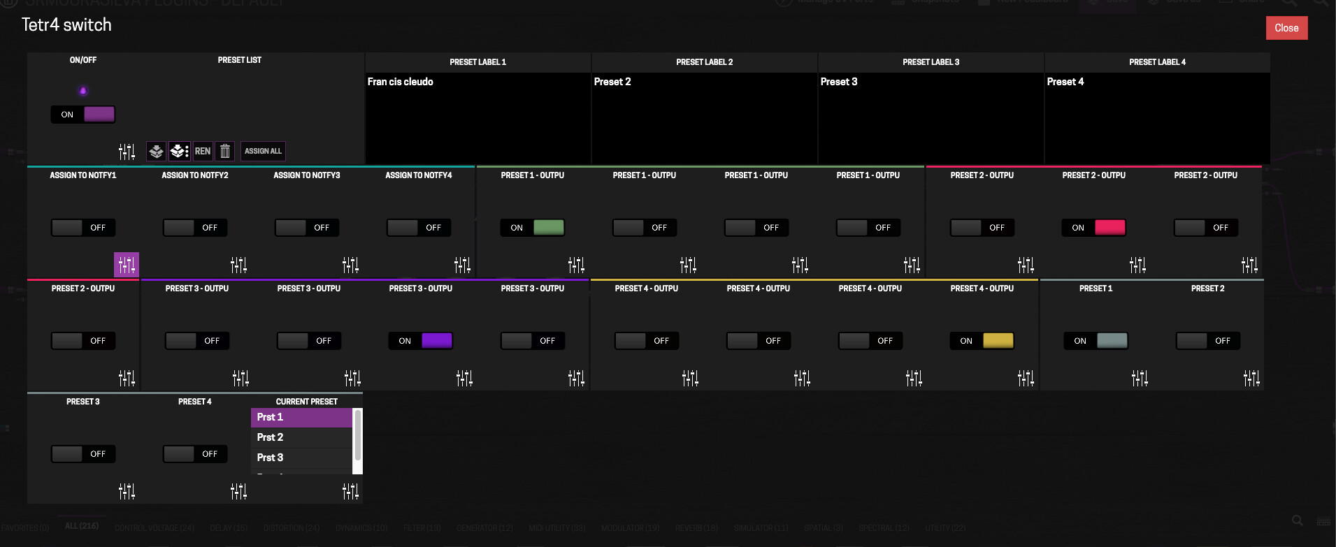

To get an idea this is TAP Equalizer/BW before:

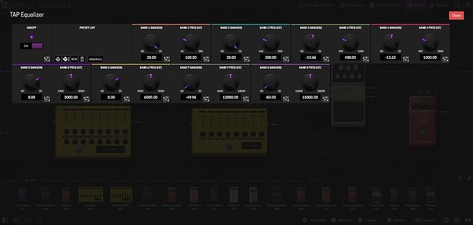

And after (mod-ui patched and the plugin ttl enriched with lv2 port groups):

This is just a proof of concept, but honestly it’s super handy. With Dwarf, my first frustration was trying to assign a button to the mod-mixer plugin, without groups, I had to carefully read every label just to find the right channel.

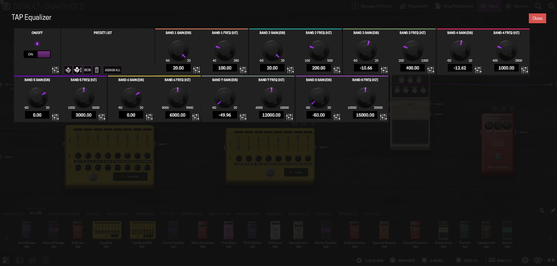

Perhaps you could change the white text to black text on the yellow background.
And maybe you could try something like dividers to mark the different sections instead of colors. To make it a bit less in your face. But it might be too unclear then of course.

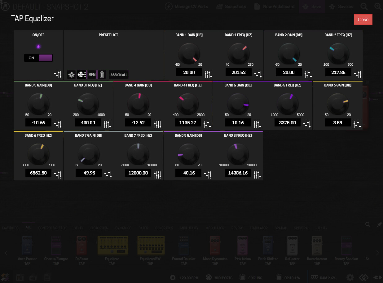

For example this could be another simple approach with less visual impact:
:wave: Andrea

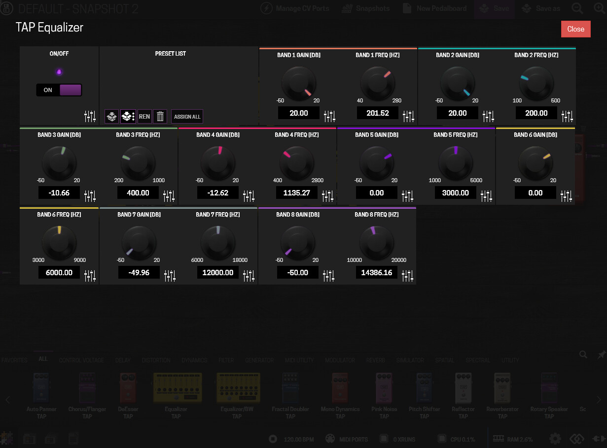

Here a quick hack: dirty edited the knob.png file to make the stripe transparent and added some css class and divs to paint the stripe.
Looks good, but not perfect:
or this with a thinner top border:

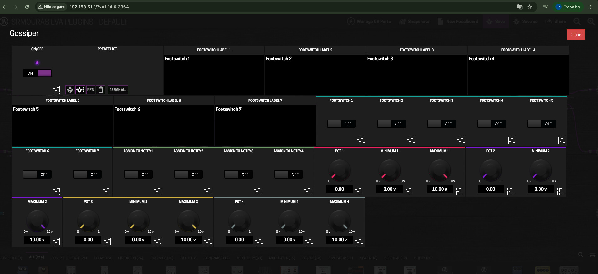

In the official 1.14 release, for plugins that employ port groups, I don’t see the nifty knob color change on the tick mark that indicates knob position (still the purple). I imagine most of you are on Starless, but does anyone know if this was a choice or an oversite, I think it would help me to stay oriented to see the colored tick marks. There is, however, an eerie theme-colored glow around the knobs that are part of port groups. Anybody know if these were choices?
I’m not sure if refreshing or restarting will do the trick but I swear the tick marks were purple when I first checked out a plugin with the custom port groups on 1.14. But the next time I used my Duo they were there.
