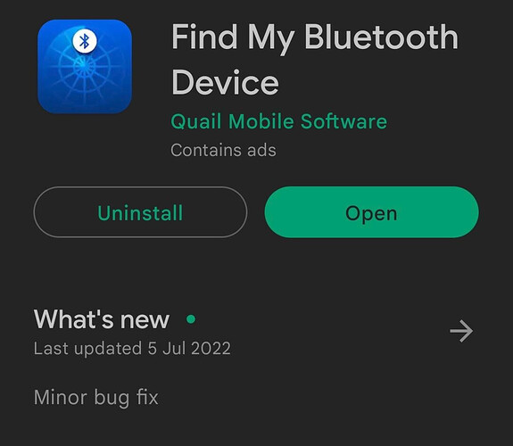

Sorry, I didn’t catch the question. I tested the device with the firmware rtl8761b_fw.bin and it didn’t work with my android devices. Is there any new firmware available to test with my Maxuni dongle?
For those having problems using this dongle with android devices, try searching the MOD using the app ā€œFind My Bluetooth Deviceā€. It worked for my Huawei Mate 10 Pro (Emui 10.0.0.202).
Nice tip @redcloud! Thanks for sharing it!
