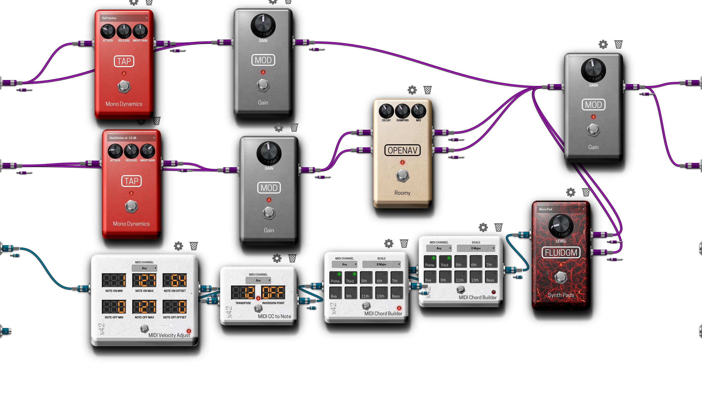

I found that when the unit is not plugged into my computer it doesn’t seem to be clipping as much. But when I add reverb plugin after the String Pad it starts to clip a lot again. I guess that connecting to the GUI uses some of the CPU. This pedalboard, as is, is right at the cusp of glitching out when not connected to the computer.
I hope there will be some research into these sound generators so that they don’t use much CPU.

I presume you mean that the StringPad starts causing xruns when plugged in with the UI, because the CPU load goes up. The DSP parts will remain identical if the UI is plugged in or not

Is there a way this plugin can be made to not use so much CPU?
