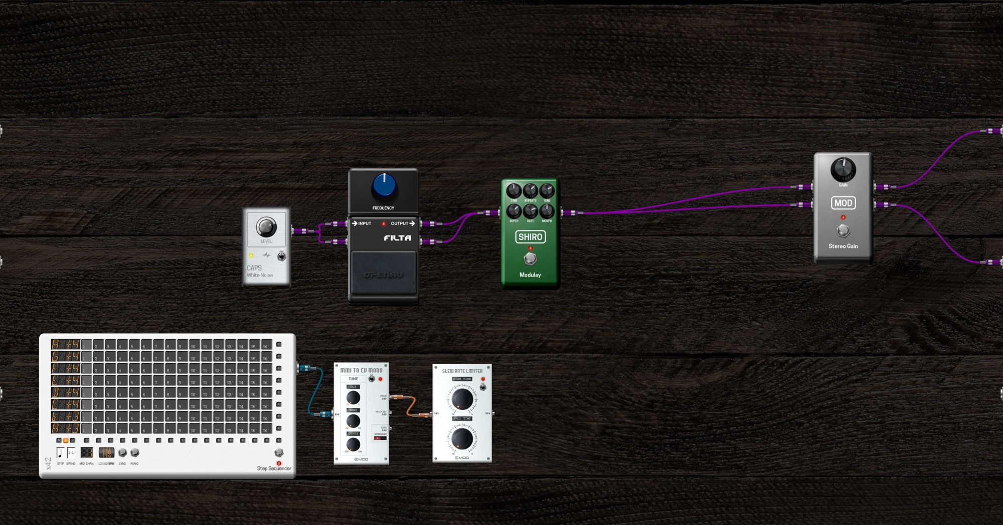

You can try something like this too:
Alternatively, you could use velocity as the parameter that sets the modulation depth, instead of the pitch. In order to do that, open the plugin settings of the sequencer, and turn the knob for each step to the desired modulation level, and connect the velocity output (instead of the pitch output) of the MIDI-to-CV plugin to the slew rate limiter.
That could also allow you to get creative with note range splits, and have 1 automation lane per MIDI note in the sequencer. Let me know if you want a more practical example of that, will take me a bit longer to whip up.
