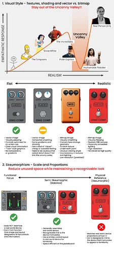

The most of the current plugins are pretty wasteful regarding the space they require. If you look at the example below, you see that the magenta tinted area isn’t really serving any purpose.
While this is ok in a small chain of a few pedals, it can easily get frustrating when you really want to use the capabilities of the MOD platform. There you are likely to deal with 10-20 pedals so you start scrolling, zooming and arranging a lot. But even if a signal chain is smaller, it can get messy on small screens like on mobile devices (The tool of choice when gigging)

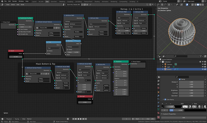

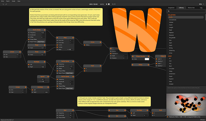

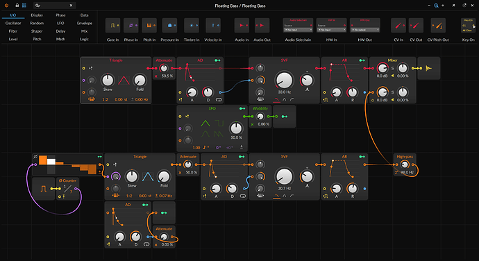

In the other thread I suggested a different UI which is more focused on that purpose. For example have a look at these:
Bitwig (Grid)
Blender
Resolume Wire

Also for any vendors/brands that want to sell or promote their specific plugins it would not be favorable to not be able to stand out with their own design identity.

I think the answer to that is to just replace the tin with something less ugly. Perhaps a nice solution would be to have a kind of node view underlying all plugins and if a GUI has been added to a plugin it will appear that way. If not, it appears like a simple node where the IO and parameters are automatically populated in a very simplified way like the “resolume wire” example. Then the user could have the option to toggle off all GUIs so that every plugin appears that way if they want
No denying it is more functional. A Tesla model S is more functional than a Mustang, but people still like mustangs. We can’t exclude those people, or more so, excluding them would be shooting ourselves in the foot. For many people, the skeumorphic GUI is what brought them to MOD. I would always aim for this to be an option.

This is a huge reason why I buy hardware. Most of my synths have a “knob per function” layout which gives me immediacy in my control over the sound I’m manipulating. It’s personally what I prefer, but also have some synths that require a little bit more menu diving. Those synths generally get less use though.
You are falsely assuming that all plugins are made for MOD platform, which they are not.
The vast majority of plugins we have in MOD are originally based on desktop versions, which has completely different UI requirements.

On a personal feedback side, I like the idea that @Klaustrophil is dropping here. I see quite some value on a GUI along the lines of the Bitwig one. But I also believe that something more graphic and closer to what we currently have is important for many users (even those that prefer the nodes option but sometimes already have pain in their eyes while looking at it).
