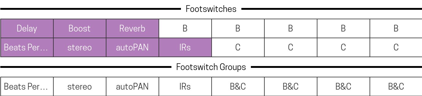

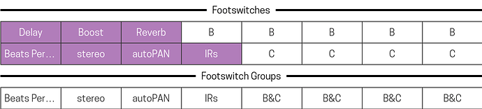

  2. On the binding page I think the last line could be a bit confusing, maybe it could be written used separately or just a X if the B or C footswitch is mapped elsewhere ?

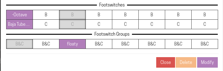

this is how I’ve implemented:
