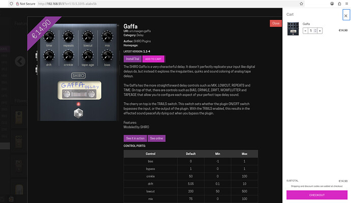

Good news, with the help of @falkTX now starless firmware seems to support the plugin store:
I didn’t finalize the purchase, but the store seems to work as with the official image.
A new release is planned soon :slight_smile:

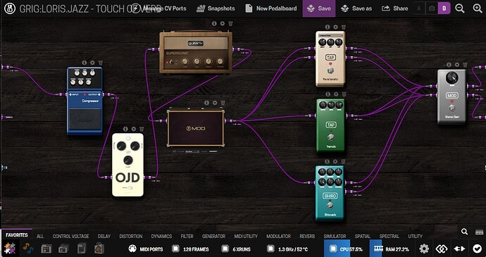

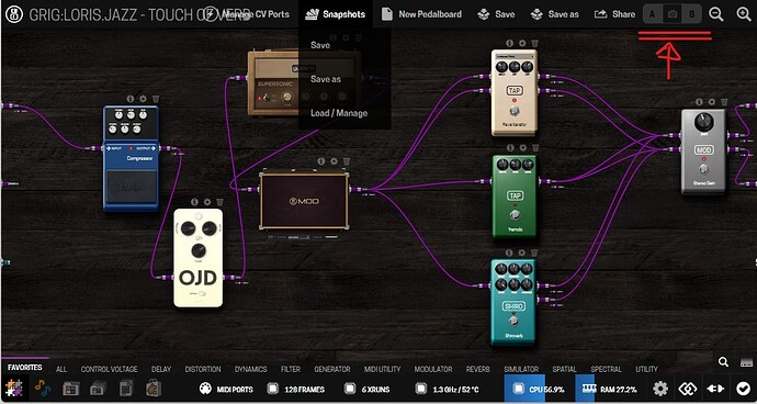

A/B Compare for Pedalboard Parameter Tweaking
Alongside store support, the next release will include a small but useful new feature: A/B comparison during pedalboard parameter tweaking.
How It Works
Suppose you want to adjust some parameters on a pedalboard and quickly compare your changes with the previous state.
In this version, when you load a pedalboard, you’ll notice a new A/B Compare section in the upper-right corner of the interface.
This section contains three buttons:
  • A – Switch to the A parameter slot
  • Take – Capture the current state and store it in both the A and B slots
  • B – Switch to the B parameter slot
At first, all controls are disabled except for the Take button (represented by a “photo” icon).
When you click the Take button, all plugin parameters are stored in both the A and B slots — essentially creating two in-memory snapshots.
After this initial capture, A and B are identical, and the Dwarf automatically switches to the B slot.
You can now start tweaking the knobs while switching to the A slot to compare and listen to the differences.
You can move back and forth, editing each slot independently and switching quickly between them to hear the differences.
Each time you switch slots, the current state is automatically saved to the corresponding A or B slot.
Once you’re satisfied, you can save the current state to the pedalboard or as a snapshot, just like usual.

I confirm: the store is now fully functional (I treated myself with another plugin :)).
I’m not able to see the new buttons for AB comparison: i purged the cache and changed browser but nothing so far. Maybe tomorrow I’ll give it another try, as now I’m in a hurry.
Thanks again for improving this platform!
Hi Abotte,
don’t waste your time I forgot to push before doing the release so the Compare AB was not included.
I just updated the alabs5b image this morning, so re-download and re-install it.
Important: since I didn’t change the image version, after you connect the web-ui force a complete page reload: shift+reload button on firefox, ctrl+reload button on chrome.
Sorry yesterday I was a bit tired :wink:
Thanks,
I got the new image, everything is fine :slight_smile:
