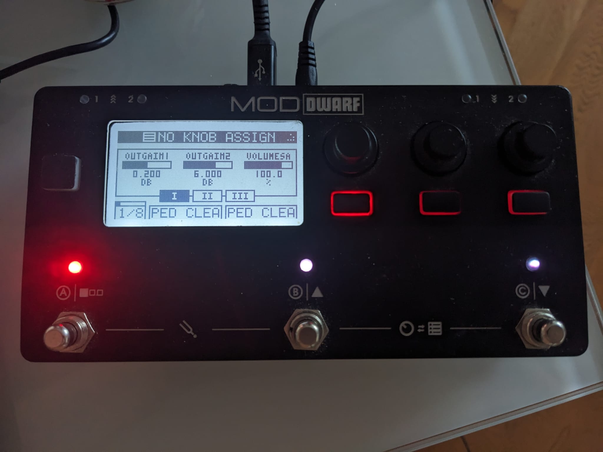

Sorry but I don’t understand your problem: can you describe better, what you expect to see and what you see instead?
Sorry, here’s a quick video, hope that clears things up.
I should be seeing the linked switches and knobs I chose for different plugins or have they been reset ?
I can’t manage to boot the web UI right now for some reason so can’t check if the links have been reset …
I think that you expect your configured controls there, so think there’s a bug trigger by some plugin you are using.
Can you send me the pedalboard?

Yes. It seems that the device assignments aren’t recognized in some pedalboards created with the official MOD firmware. I’m trying a workaround by modifying the addressings.json, but I haven’t found a solution yet.

Send me one of such pedalboard please, I’ll take a look before the next release(which is planned this weekend)

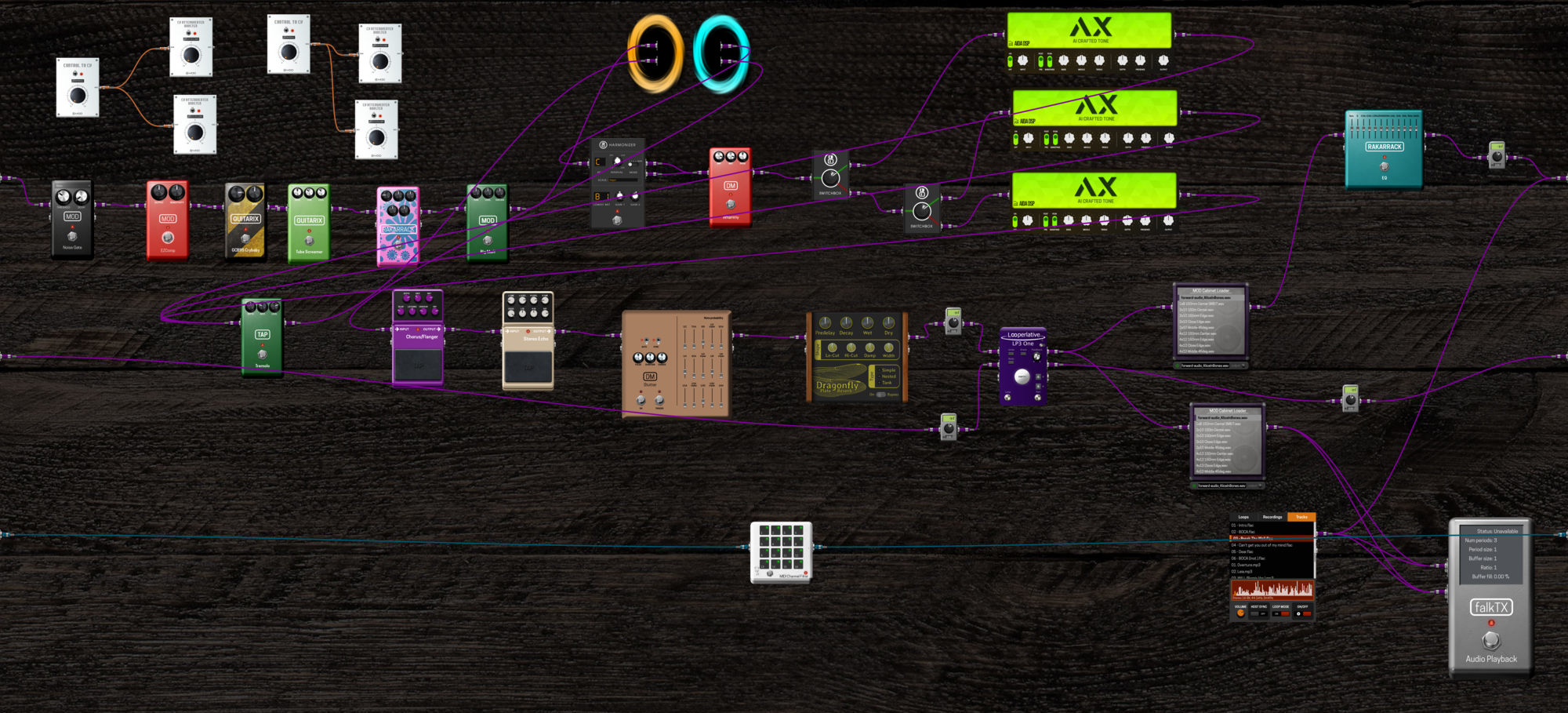

This is my pedalboard:
Hey would you mind explain to me how you found the link to your pedalboard as it doesn’t appear on the home page of pedal boards and I can’t find mine either that was published three days ago :thinking::pray:t2:
I’m not sure… I can go here: AX_Bruno059v6 - MOD Audio
Use the Try now link with your Dwarf connected via USB.
Thanks, I can reproduce the error, let’s see if it can be fixed quickly
I need to investigate a bit more, but it was an easy fix, the real reason is why, pratically that part was the original Dwarf code…
Thanks for the pedalboard example!
