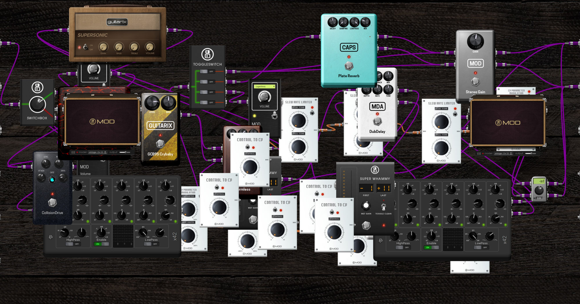

I will try later to make a video. I assigned HH to Control to CV plug, very useful plugin - I can assign HH motion then to multiple parameters.
Finally I had some time with Hot Hand - it is designed to work with Mod. The best way is to assign HH to Control to CV plug, so it can be assigned then to controll many parameters. I assigned it to the volume plugin (reversed) so I can make volume swells with moving guitar neck. I also assigned HH to ambient style sound path, so the sound can be mixxed in also by moving guitar neck.
