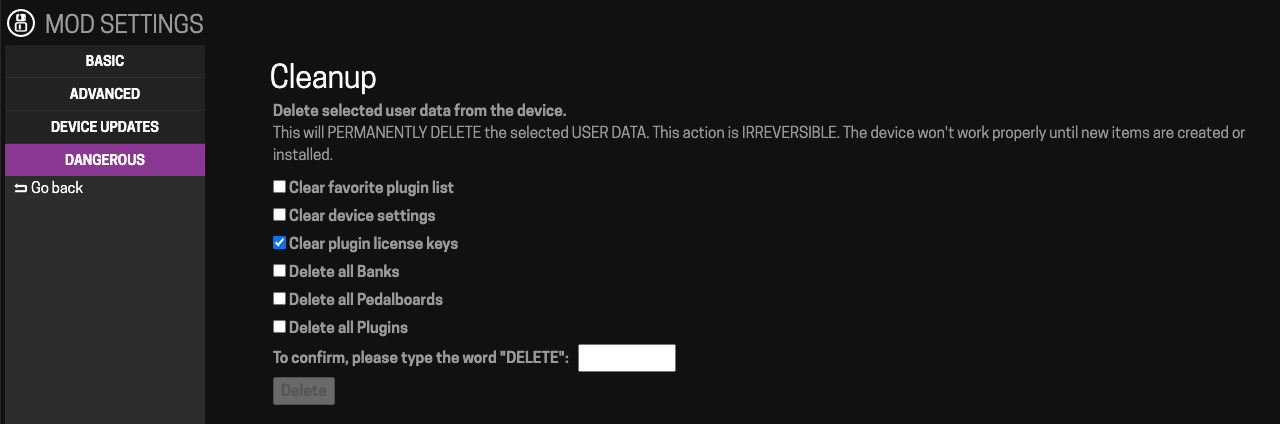

One year ago I had the same issue, Gianfranco’s answer was:
" Please delete the plugin license keys in the advanced screen and reload the UI. "
Seems a bit scary but worked for me…

Yep. That’s what should be done, so that the system updates the licence info.

Before that, I would suggest you re-install the plugins as well.
If you want to go hardcore, back up the device (including plugins) and go to the dangerous section and delete all plugins. Then restore the device with the backup you did.
Thanks, it works. I’ve reinstall everything.
