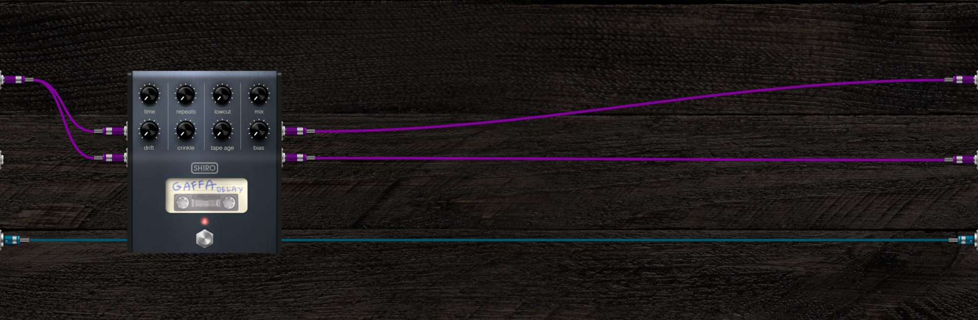

I thinks you where right @mj_prod, it is way nearer with delay :
And with little help from the RMPro :
