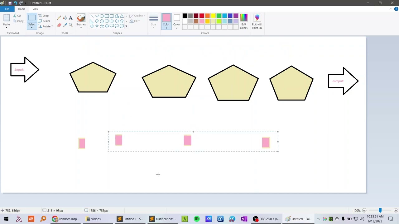

had some ideas for better CPU utilization, made a video:
When I say “build the portal effect into the reverbs” I basically mean use background threads on the algorithmic reverbs the same way the reverb convolver does. You get a one frame delay but better parallel processing.

I am not on my dwarf now and I can’t tell for sure, but I think that using some kind of “switchbox” or “toggle switch” to have your reverbs in parallel could help distributing the load on the threads

It is not a lot but if you use only 1 reverb at time using the 4-to-1 toggle switch you can spare a 10% (at 128 frames)
@Zavorra
It shouldn’t matter whether you do a toggle switch, or volumes, or do all 4 at once, or whatever, the important part is that they are parallel vs serial. if they all came out from a chorus effect (for example), as soon as the chorus is done with it’s buffer the 4 reverb effects can get started working on 4 different CPU cores. Of course, if they all join together after that, you have to wait on the “weakest link” reverb to finish before the audio can get to its next destination.
Parallel vs serial is making the magic happen, not the toggle switch.

As you can read, this is exactlyy the meaning of the post. It was a reply to @looperlative which uses to have multiple reverbs in the same pedalboard to use only one at once, using a parallel layout can help spare some “CPU” without adding latency like a portal whould do. OTOH you need a switch to mute the unused reverbs dry signal… no magic at all…
@Zavorra got it, sorry if I came across as rude
