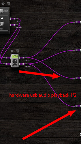

Sweet, got it. Found this thread here Duo X as USB Audio input and MIDI device | EXPERIMENTAL - Feature Requests - MOD Audio Forum that said there are two more outputs/inputs on the Mod web interface to route audio to!

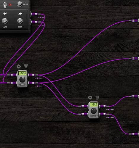

It even works plugged into my Pixel 3 using the USB-A to USB-C adapter/dongle into the Google Photos app, it shows up as a wired microphone!! It does seem a bit hot though, so I put another Tiny Gain on just those outputs and dropped it a bit and it works great:

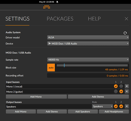

Side note: somehow it stopped working after trying to test out Bitwig. I noticed that if I choose jack mode in pipewire or udacity it shows it as “Multifunction Composite Gadget Analog Stereo” but if I choose alsa mode in pipewire it shows as “MOD Duo / USB Audio”.
I was able to get it to work in Udacity earlier and record something with Jack “Multifunction Composite Gadget Analog Stereo” but now I can’t get it working again. Including making sure usbgadget is running on the Duo and restarting my laptop.

K, I tested my phone again and it showed up as a wired mic, but recorded no sound in the Google Photos app. And Open Camera didn’t show the mic at all. So I power cycled the Duo and it is working again now, including in Bitwig with Pipewire’s Alsa mode w/“MOD Duo / USB Audio”! It is hard to use that way though because, as noted, you can only use it for input or output right now, not both, so playback has to be switched back to my laptop soundcard.

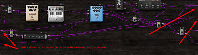

K, I read through Duo X as USB Audio input and MIDI device | EXPERIMENTAL - Feature Requests - MOD Audio Forum a bit more and realized that was for the X, and that Audio Through USB - MOD Wiki suggests capture is supported. So I simply connected the USB Audio Inputs to the regular Hardware Playback 1 & 2 and it works. It is a bit gargley, but this is good progress so far!
