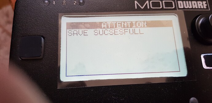

PS: there is a typo in a message displayed on the Dwarf when we press the Save button on the navigation : ‘SAVE SUCSESFULL’

This is on the v1.11 early build you have, this dialog is not present on regular v1.10
There are a few elements on the pedalboard management on v1.11 that do not work yet.
We are working on this right now, there is no point reporting issues about it for now until an official Release Candidate build is made.
