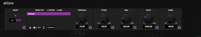

Is anyone knowing if it exists a noise gate pedal in those accessible with the Dwarf ?
abGate is one of them.

abGate looks more as an envelop filter than as a noise gate ?
From https://en.wikipedia.org/wiki/Noise_gate:
Gates typically feature “attack”, “release”, and “hold” settings and may feature a “look-ahead” function
and
Noise gates have a threshold control to set the level at which the gate will open. More advanced noise gates have more features.
The release control is used to define the length of time the gate takes to change from open to fully closed. It is the fade-out duration. A fast release abruptly cuts off the sound, whereas a slower release smoothly attenuates the signal from open to closed, resulting in a slow fade-out. If the release time is too short, a click can be heard when the gate re-opens.[citation needed] Release is the second-most common control to find on a gate, after threshold.
The attack control is used to define the length of time the gate takes to change from closed to fully open. It is the fade-in duration.
The hold control is used to define the length of time the gate will stay fully open after the signal falls below the threshold, and before the release period is commenced. The hold control is often set to ensure the gate does not close during short pauses between words or sentences in a speech signal.[4]
The range control is used to set the amount of attenuation to be applied to the signal when the gate is closed. Often there will be complete attenuation, that is no signal will pass when the gate is closed. In some circumstances, complete attenuation is not desired and the range can be changed.
and are using dedicated algorithm to control noise
… and more similar to what guitar players use since years.
I won’t show you the buttons of a EHX Sillencer or a TC Sentry or my Source Audio L.A Lady or even my Hughes & Kettner amps.
And won’t show you the envelop filters of any of my synths but you could easily see that this is more similar to an envelop filter.
I don’t want to sculpt sound but remove noise created by Dwarf…if they are on its input side…
