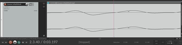

Well, all I can imagine is that something else is causing those pops. I have never had a situation where I could hear something like a pop or click repeatably and could not see it in a waveform. Normalization isn’t going to affect something like that. If you want something that will show up “missing sample” (e.g. XRUN) clicks really well, just use a 220 Hz sine wave. It doesn’t have much in the way of harmonics so any discontinuity really leaps out. It’s also super easy for other people to do the exact same test (more or less).
I must admit it freaks me out a little bit that the other guy says his unit has these exact same types of pops.
I can definitely hear the pops and it is also visible in the waveform.
I am not sure if the clicks are the same I am hearing when there are xruns.
I removed any ‘gain’ type plug-ins from my pedalboards, unplugged the USB, and was 100% successful in eliminating the pops. I still rarely get very faint noises that sound like a flame being doused out with water (kind of like a ‘phhhsssssst’ noise) when playing my guitar hard. My bass has no issues now, which is great. Still would like a limiter at some point at the end of the chain, but very very happy with the Dwarf now.
