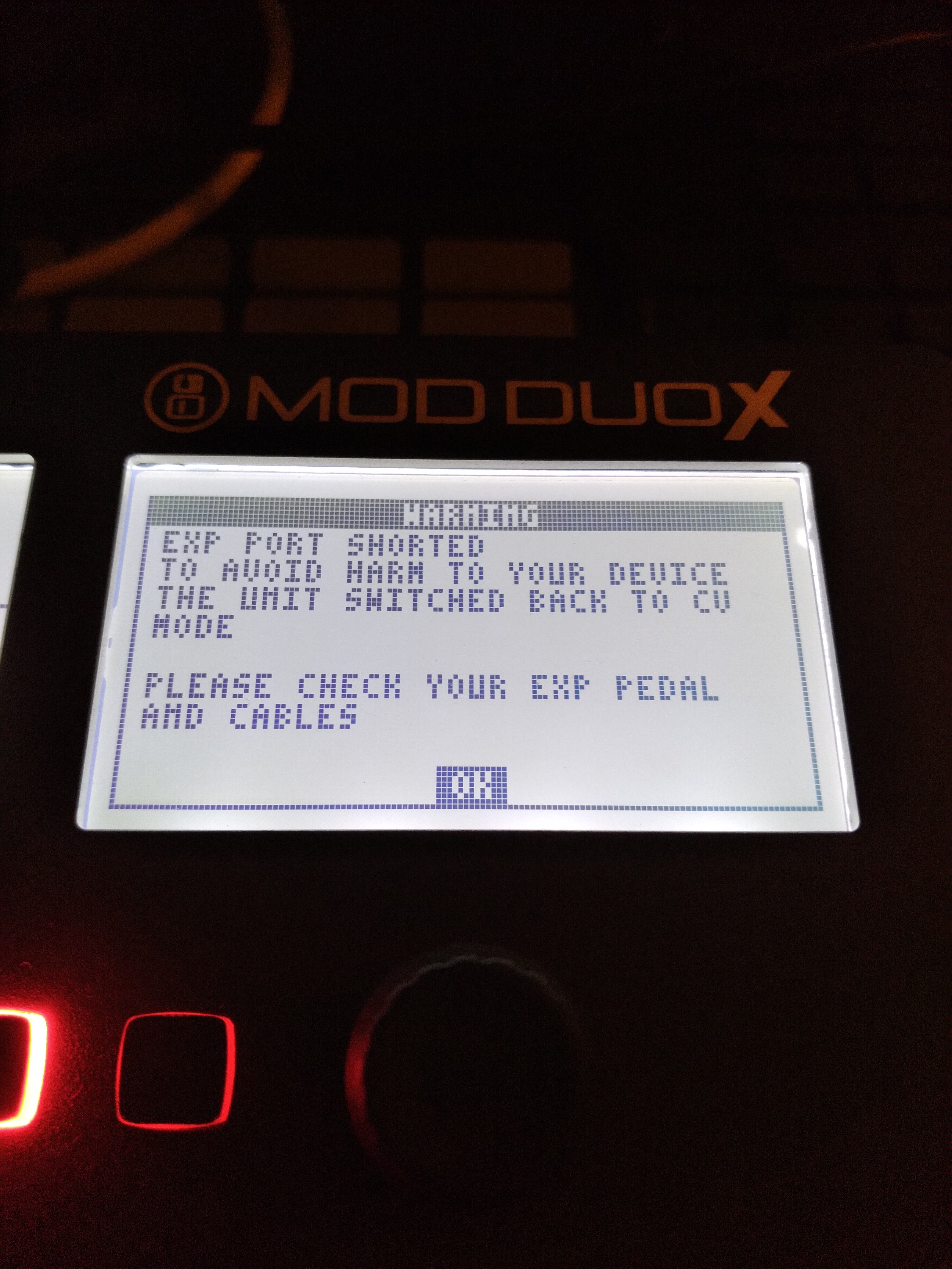

Holding left rotary encoder button does nothing.
Can you still access the web interface?
The exp.pedal warning is a pretty serious one, is it showing up by accident or did you have something connected on the CV input?

I had something connected to the audio input but not the CV input. Plus I cannot access it from the web interface

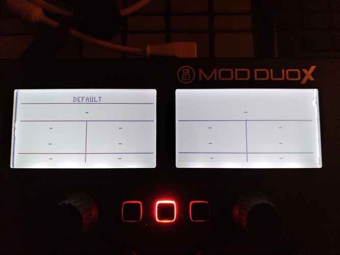

so this isn’t working unfortunately
- Turn on your MOD
i see the modduo x logo
- Let it boot until you see “Knob 1” etc.
i dont’ see anything other than
this page
https://forum.moddevices.com/uploads/default/original/2X/f/f3a183023839e3af41390993a3a2412418ff68be.jpeg - Press and hold the left knob until a menu appears in the display
nothing happens
