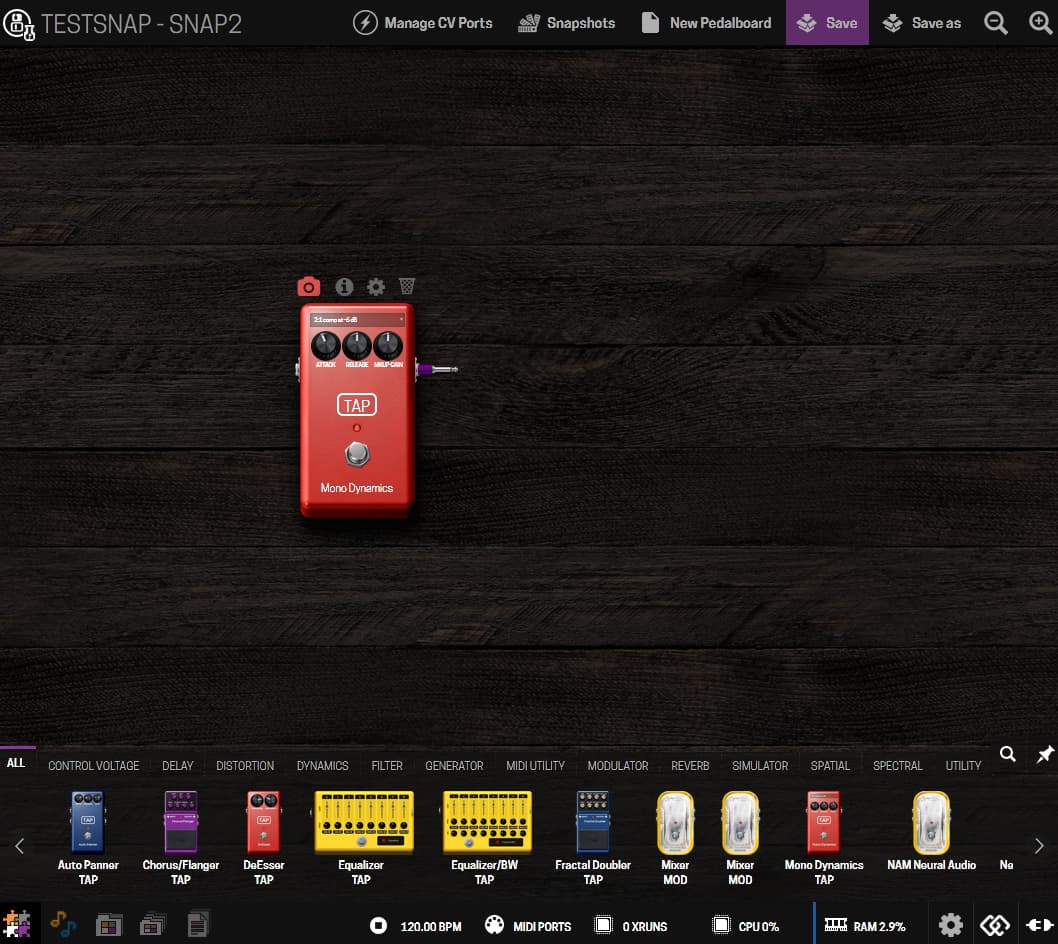

At first glance the contructor is clean as always:

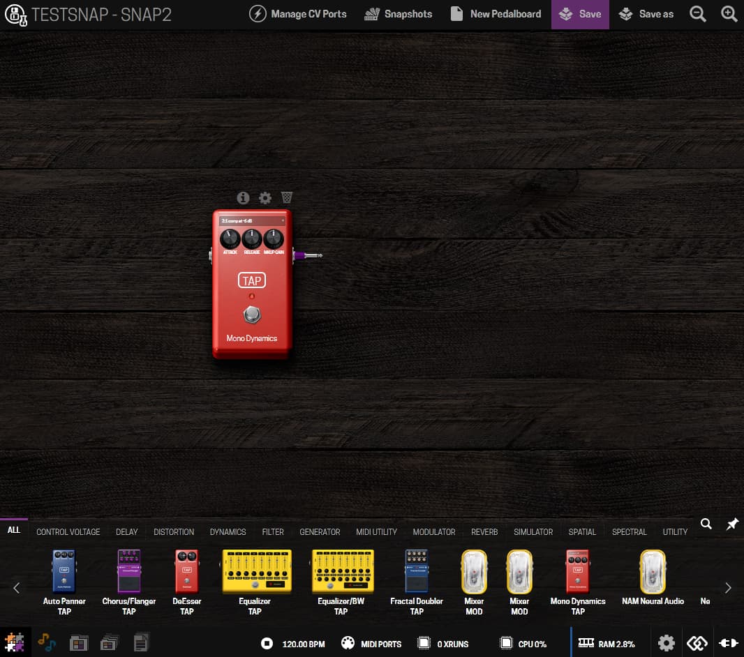

But when you hover a plugin you may see an icon that reflect the status of the plugin:
This is useful when you change a parameter from the “stompbox” ui, because you will see that not all the plugin parameters will be included in the snapshot and if you don’t remember which parameter, you can check it on the settings page (the usual gear icon).
This is the icon meaning:
  • NO ICON: all good, all parameters will be saved
  • immagine: some parameters are excluded
  • immagine: the entire plugin will is excluded

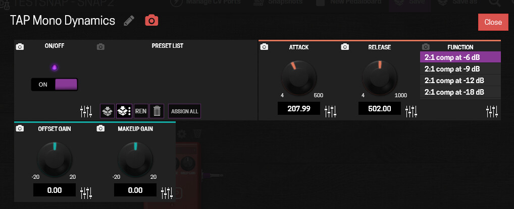

By clicking the gear you will enter the usual settings dialog and do all the settings for the snapshots.
Configuring Snapshot bindings
On this dialog you see the plugin icon like on the constructor, by clicking it you will bind/unbind all parameters to snapshots.
For every parameter, you also have a snapshot icon that can be use to just bind/unbind that specific parameter.
After changing any bindings you need to save the pedalboard

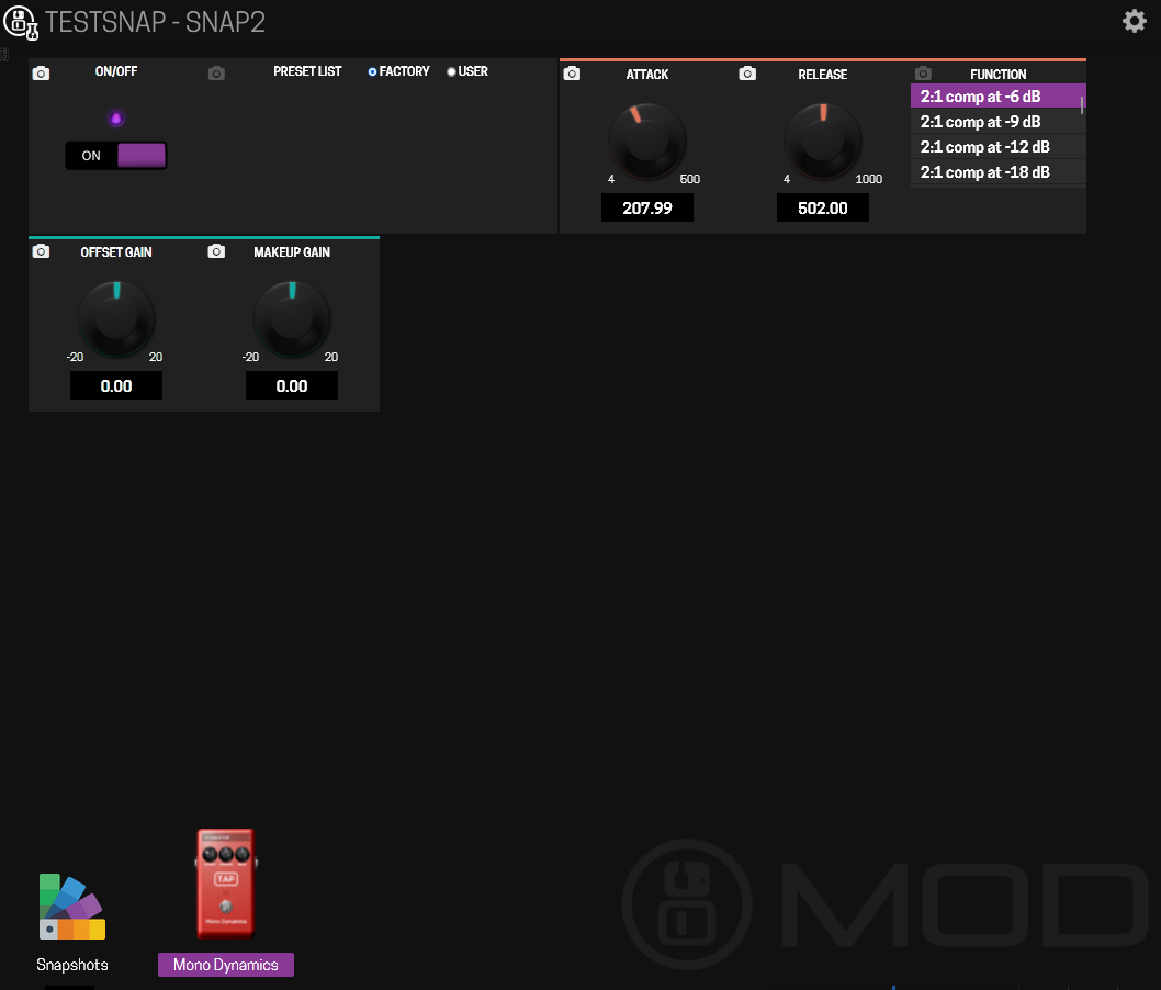

Performance view
In the performance view you will see, but you can’t edit, all the parameters bindings:
