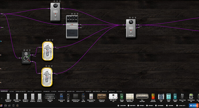

I’ve tried switching between snapshots with different mono reverb IR’s (1 short and 1 long) and I always get an unpleasant click or pop as I change. A solution I found was to run 2 instances of LSP mono reverb IR plugin and use a switch box to midi A/B between IR’s. This is seamless but the CPU gets maxed out so is not going to fly.
I’ve tried various other ways of quickly switching away and back on a single instance of the LSP plugin using the switch box and doing the snapshot change in between but the issue remained.

After some messing around, I managed to get rid of the noise going from short reverb to large by putting an early reflections plugin before the LSP IR plugin but looking at some sort of ADSR single shot control of a gain module to handle the return journey to the short reverb again. If it works then it might be slightly elaborate but will keep looking for the most elegant workaround.
