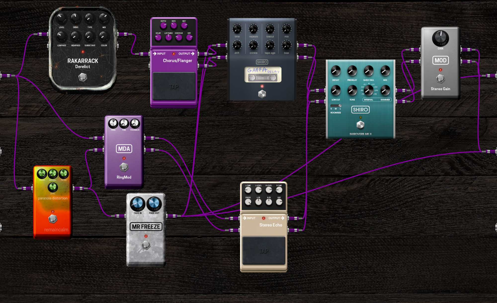

This pedalboard is a melting pot of strange ambient sounds, a pseudo sitar, and a bad fuzz.
The B button is used to record a pedal note with Freeze plugin.
while Button C alternates 4 snapshots:
1-clean with ring mod.
2 -Sitar
3-Fuzz Sitar
4-Fuzz...
I had created on my Ax a pedalboard that I tried to reproduce with the dwarf.
I must say that if everything is not perfect, the dwarf still manages to do great things!
2 -Sitar
3-Fuzz Sitar
4-Fuzz solo

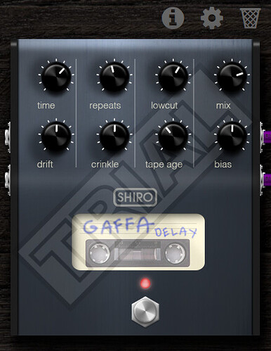

I tried this - the sounds are gorgeous but on my mod dwarf at certain points, the sound goes totally clean - the cpu is around 50% the ram 21.5% - as I say it cuts out (becomes clean in the headphones) - then after 3 or 4 seconds suddenly returns - no rhyme or reason
modfox
September 19, 2021, 8:05pm
5
Hi!
Same here. Depends on if you’ve bought the Shirover MKII and Gaffa.
I haven’t (yet) and as stated experience the same thing.
All the best
Anders.L
jon
September 20, 2021, 10:12am
6
Yep. As @modfox mentioned your problem is most likely due to the fact that you are using plugins in it’s trial version.
steve
September 20, 2021, 3:14pm
7
H modfox/jon
Apologies if this is a silly question: how do you go about buying (or even just finding the price) of a plugin?
Steve
modfox
September 20, 2021, 4:57pm
8
Hi Steve!
Like Jon has said; there are no silly questions
In the webgui clic on “i” icon for the effect.
Then opens a new window and under the name of the effect it says “add to cart” and off you go
