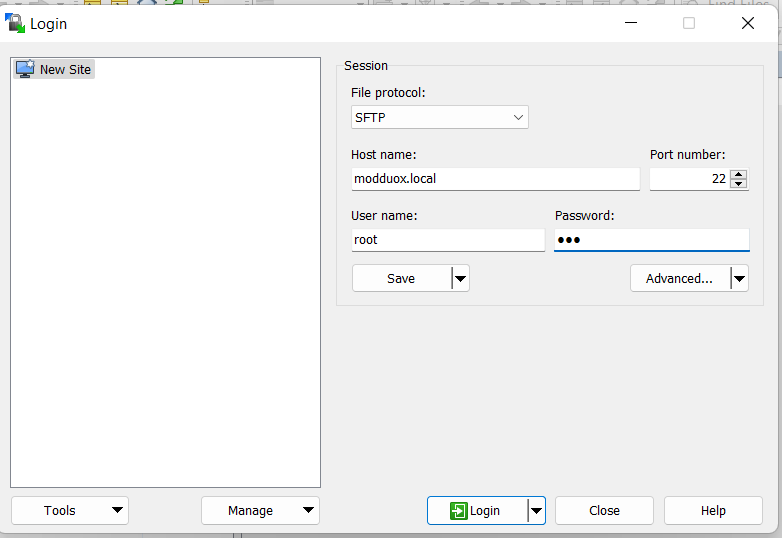

In WinSCP create a New session:
4) ---------------------------
Login is root,
password is mod,
Host name is the address you use to access mod device in browser, but without https:// prefix
Duo: modduo.local
Duo X: modduox.local
Dwarf: moddwarf.local
Press Login, (also you might want to Save session to evade filling all the fields next time)

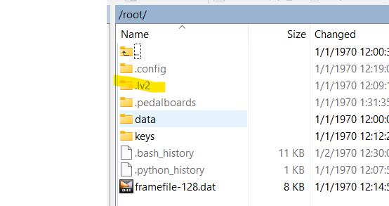

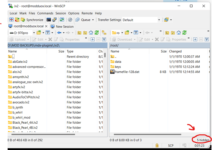

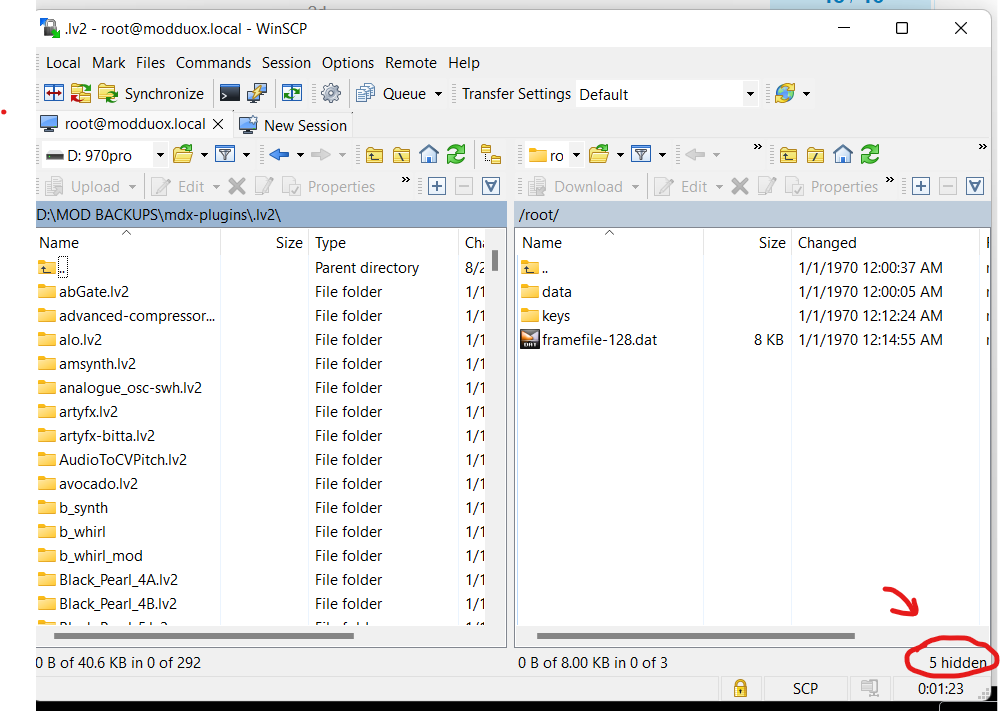

Now you have two panel file browser, left side shows your local files, and the one at right side is the remove file system of you mod device. Be careful, you are connected as root (superuser with admin priviliges), and have possibilities to break something on the device. Try not to remove or move folders on the device randomly.
Location of the plugins on the mod device is /root/.lv2
However, folders starting with a dot are considered as hidden, and winscp does not show the required folder. Click on “hidden” label at the bottom right:
Hidden folders will appear, and now you can navigate into .lv2 folder:

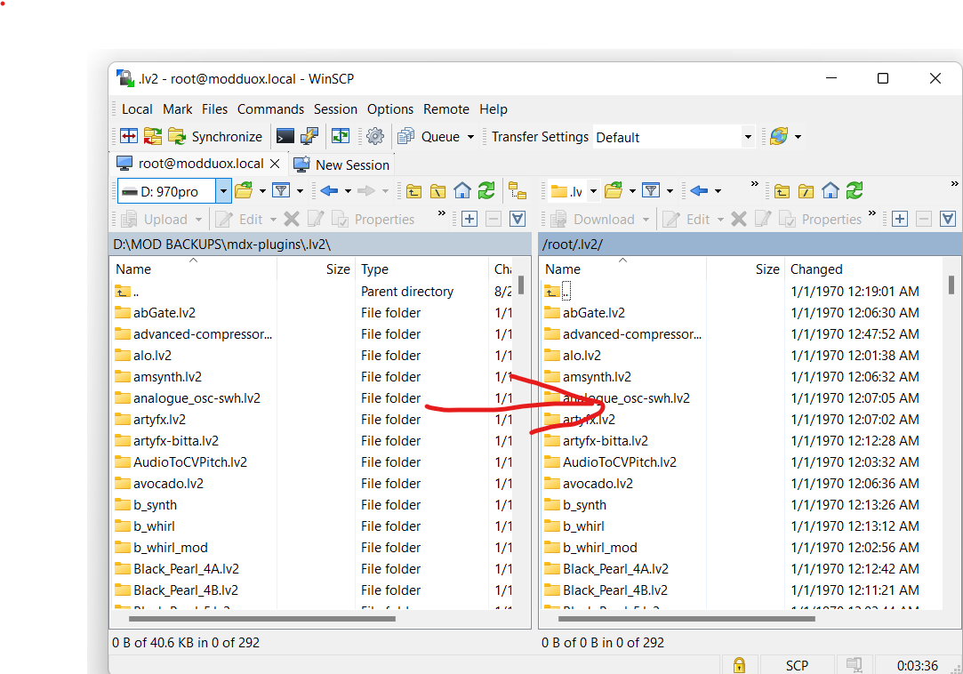

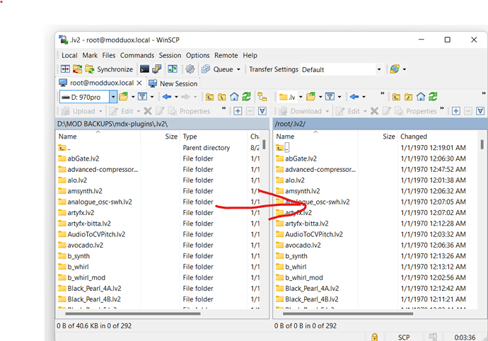

6) ---------------------------
Now you can copy plugins you need from your local file system to the device:
