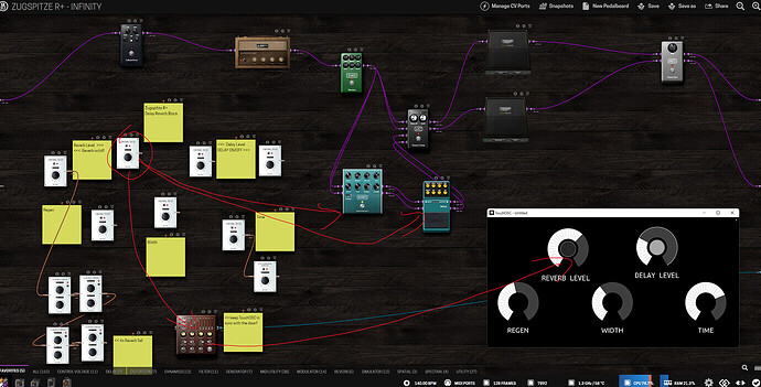

In the meantime, if you want to get that functionality and don’t mind the mess, there is a way to map parameters to midiout. Map a CV control to a knob and the mindi plugin.
I’ve used the setbfree because that has more midiout parameters at once.

So I don’t really understand the request @Marco_Gatto.
This is already possible if you use the infamous mindi. You only need to set the new snapshot to trigger it.
