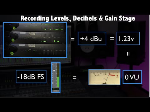

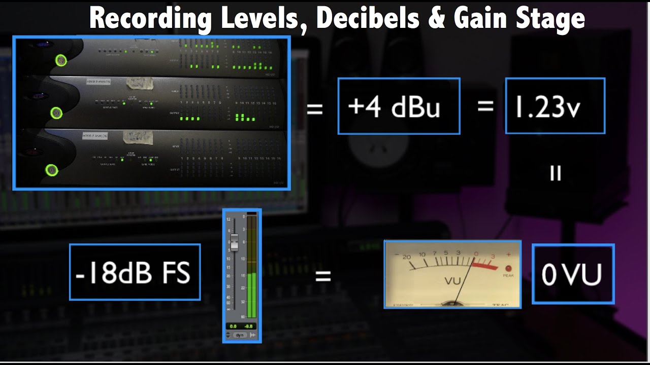

On this video section below there is a nice example of that.
To test that, I generated (Daw Oscillator Plugin) and recorded a -18dBFS 1Khz sine wave on my DAW, uploaded to the MOD “Audio File” plugin and played.
The reading inside the MOD DUO was exactly the same (-18dBFS), so my guess is that the MOD DUO is calibrated at -18dBFS.
Can you confirm this information for me?
I couldn’t find any mention to that on the documentation neither on any threads here at the forum but maybe I’m missing something.
Next test will be to record the input of the Scarlett with a -18dBFS signal and upload the result to the MOD DUO to check how the DUO will read that.
