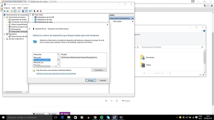

Cause there is no ‘Remote NDIS Compatible device’" on microsoft corporation like in windows 7, I tried to install other Remote NDIS Adapters, but isnt work… Any suggestion?
There is definitely a “Microsoft Corp.” RNDIS driver in there as I’ve seen it myself (unless your version of Windows doesn’t have it, but that sounds strange…)
Are you able to get to the point where you select the driver?
Can you do a screenshot for us when that happens please?
Thanks
I made this in Windows 7 in the same PC. But now i cant find…
I see…
What about the “Microsoft” one, not “Microsoft Corporation”.
Does that have an RNDIS option?
btw, do you know what exact version of Windows 10 do you have?
In my computer propreties says : Windows 10 pro 2015.

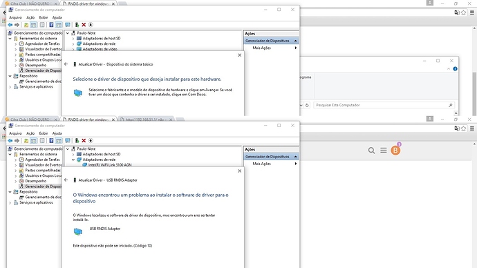

in microsoft I tried:
USB RNDIS Adapter
Adaptador RNDIS6
Dispositico compativel com NDIS remoto
and I cant install cause windows found a error:
