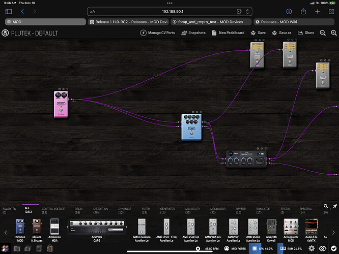

i’ve removed all the extra things in the pedalboard, and narrowed it down to some kind of interaction between the FOMP Reverb and RMPro. in the pedal board linked here, i’m seeing -inf at the output of the RMPro, and also sometimes at the output of the reverb. re-loading the board doesn’t always solve the issue.

note that, when the output of the RMPro is -inf, anything downstream of it also is non-functional. i.e. even if i connect a test signal generator directly to the device output, it doesn’t work.
ok, re-testing both this minimal board and my original performance board where i first noticed the issue, re-loading the board is usually NOT fixing the issue, so i’ve got to replace RMPro with other tools for now.
what a strange “perfect storm”… RMPro really sounds very good, and the FOMP reverb is the best in the MOD “ecology” for my horns. this is the first board i’ve built since purchasing the RMPro, and i was really looking forward to taking it to the stage.
