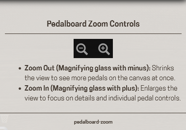

I updated my code using the marked.js library and it seems to work very well:
### Pedalboard Zoom Controls
![Pedalboard zoom](help/img/pedalboard-zoom.png)
- **Zoom Out (Magnifying glass with minus):** Shrinks the view to see more pedals on the canvas at once.
- **Zoom In (Magnifying glass with plus):** Enlarges the view to focus on details and individual pedal controls.
This renders as:

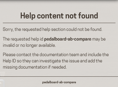

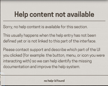

I also refined the “missing help” reporting, since we now have two cases:
  1. The help ID is defined, but the page is missing
  2. The help ID is not defined at all and should be introduced
Here is how these messages look:

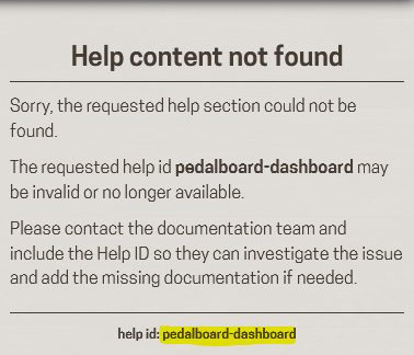

Just click around, and when you see a message like the:
Simply create and upload a markdown file into the html/help folder on the dwarf device (/usr/share/mod/html/help):
…just like I did as an example for some of the targets I defined.
