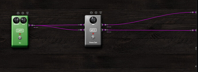

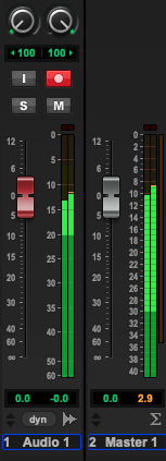

I have a stereo output balance issue with my Mod Duo X…
I use a simple sine generator and the Duo X is plugged directly in my Steinberg UR 242 sound card.
In system parameters, both output are at 100%…
Anyone facing the same issue ? Any idea how to get this solved ?

No, there is just 1 sine module… No phase issue possible with only one sine source… And I have the issue with all pedal boards I build…

are the settings on the Steinberg UR 242 identical including Hi-Z setting, PAD switch and input gain?
If you swap left and right cables coming from your Duo X, is the gain difference the same on left and right channel?
Well you are right by suggesting inversing cables… I trusted my cables as they were pro quality and brand new. It is not a cable issue but through inversing cables, I could determine it comes from my Alesis mixing desk stereo channel on which the Duo is plugged… Thanks !
