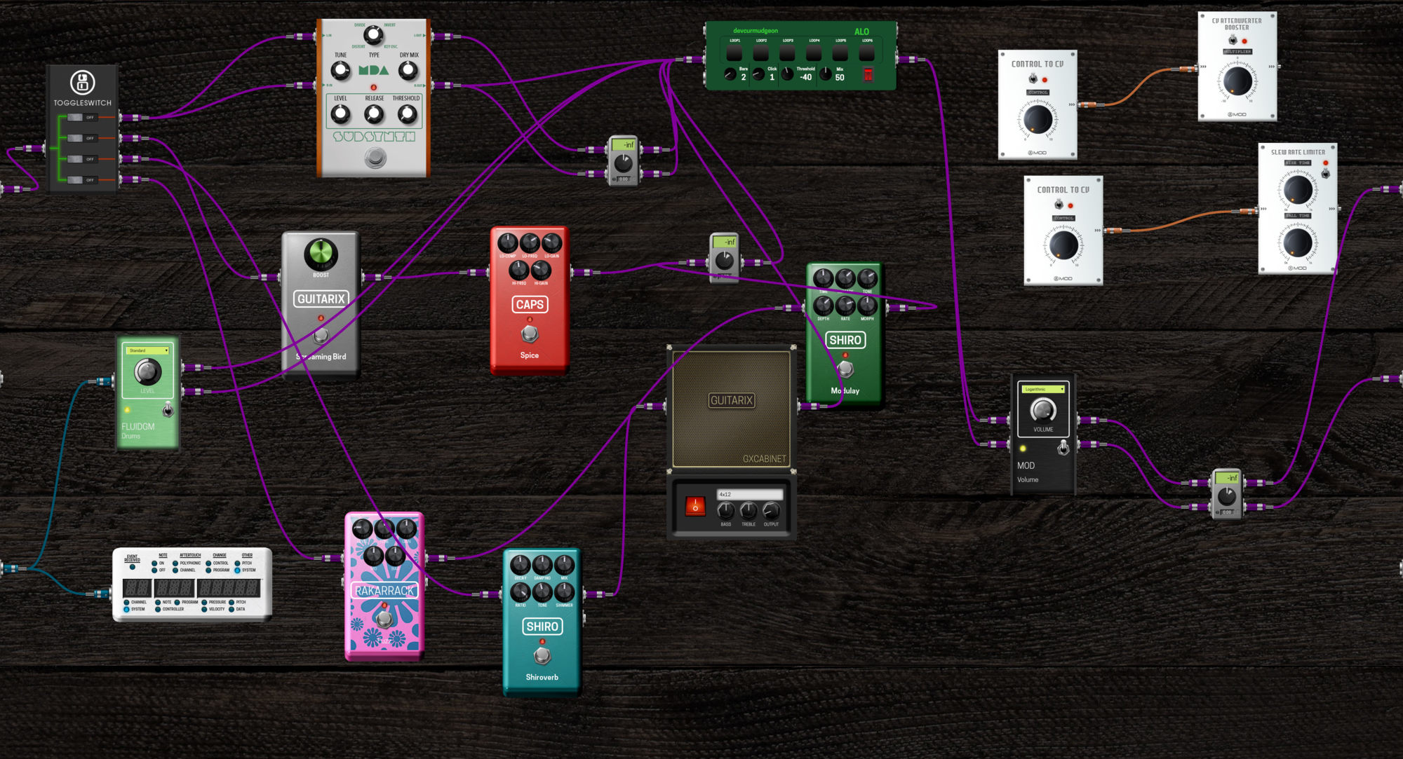

So I was wondering if anyone would be interested in trying out a kind of remote pedalboard setting up. That is to say: me going to a rehearsal studio with laptop and mic, putting the dwarf + my vocals into the PA, then someone else via Teams or some other software, would interact with the http://moddwarf.local, but hear the results through feed from a microphone in the room and then adjust it to try and get the level right.

Just a suggestion. You could send the drums to one output of the Dwarf and the rest to the other one. This way, you would have a track dedicated to the drums on the PA.
Yeah - I thought about that. But a number of open mic setups really have just two possible inputs - typically the acoustic guitar and the mic - although “backing tracks” are becoming ever more popular now (typically from mobile phones) a stereo input might be more possible. I think I need to have two versions of each pedalboard - a stereo version with the drums isolated - and a mono version with all combined
Don’t you just need to control the drums volume from the Dwarf ?
You can assign it to a knob. And if you still want to change it after the loop is recorded, you can use a stereo looper plugin, send the drums alone to one side and put a volume plugin after the looper. You can still combine things to mono further in the chain if you need.
You can also consider buying the LP3 Basic looper, which has 2 tracks with independent volumes. Try the demo version first.
