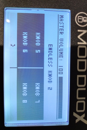

I have strange artifacts on the last row of the interface. Right know (nothing running) it looks like a closing bracket.
can you take a picture and post here please?
also, can you try disabling MIDI sync and seeing if it makes a difference for the changing headphone volume problem?
