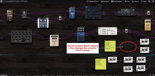

I brought to crash as usual, then logged. This is the result. The Dwarf is crashed now.

In this pedalboard is a Beta Plugin. But the same thing is with all other pedalboards, also pedalboards without Beta Plugin.

looks like this index contains a float, not an object at:
(weird that the preceeding condition resolves to true in this case?!)
I think you are looking at the wrong place? is this on hotfix-1.11 branch?
EDIT: fixed in https://github.com/moddevices/mod-ui/commit/b24bc128961475a6a6c651eacc9366e661346e8b
@Kim mind if I PM you a build for testing with the fix? to confirm before an official bugfix release

The new build works fine, no crashes any more. Thanks for the amazing support!
