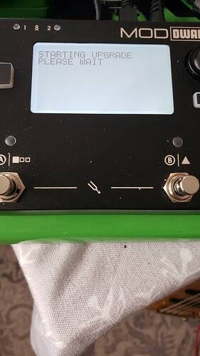

I’m connected via USB to my laptop. It seems that every other release has failed for me. I’ve contacted MOD Support but they didn’t respond. The download meter finishes & I get the message to begin installation of the upload but…nothing. It hangs on this screen (see image).

Also, I wasn’t able to see a photo on your post :confused:

Sorry about the pic - it’s there now.
Surprisingly, I was unable to find a download link for this firmware on the wiki, just the description. You may need to DM for an image.

I think this is a case where we don’t know exactly the best approach to take here.
It seems like the restore mode is broken and the unit can’t boot into it, so a full reflash might be needed. We still need to document this, it is the first time I know that we need such step so we have not had the need for it before.
Just to confirm something here, to make sure it is possible to reflash: hold down the knob 3 and the button below it for 5 seconds while powering on the Dwarf. The display should then say “Maskrom mode active”.
Is this the case for you? If so, we can then proceed to the next step for reflashing the unit.

@falkTX I’ll try to see if I can boot into reflash mode. I’m away from the device; I’ll post when I get to it.
Okay, @falkTX - I am able to boot into reflash mode. What next?
