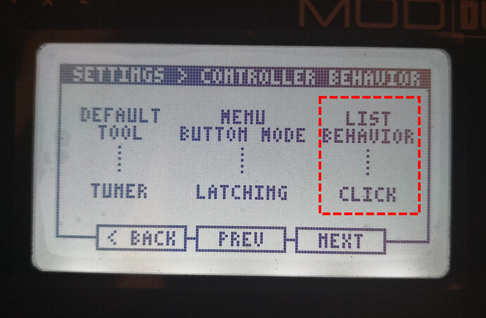

Is this the setting? How it should work?
An element of a list is just activated when you select it (scroll over it) and click on it. Instead of just selecting it. I guess it’s that.
Which kind of list? Pedalboards? Snapshots? Single parameter list?
All lists available on the device. If I’m guessing well.

Selecting DIRECT value doesn’t make any differences with CLICK while scrolling
  • Banks list
  • Pedalboards list
  • Snapshots list
It works correctly only for single parameter list. Don’t know if it is the expected behavior.
@redcloud you are right, this feature only relates to lists in control mode.
It allows to switch between the old behaviour (every turn selects the item right away) and now added, a way to scroll through a list without selecting anything until the encoder is clicked.
We had some feature requests on this, as it makes plugin presets or tempo dividers in a live performance a lot more usable :slight_smile:
